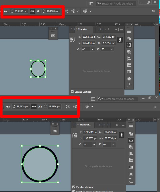

Hello
I have a problem with Illustrator 2.021 / 25.0
The Trtansform tool is working crazy. It is not keeping the proportions. The width - high boxes are checked, linked, however if I put a certain value for width and press enter the high value will be different value. This is not the first time when Illustrator is making this, a couple of years ago it did it too, the same. However that time I uninstalled it, re-install it after and it worked. Now this is not possible. I re-installed it now and is doing the same bad values. If I put 6 px high for a dot/circle it will produce a dot with 6px high X 5px width. I checked all the options and preferences, the Transform palette has both boxes checked and noting.
What do you think?
Best regards
Florin

Hi Mohammad. Yes, all checked. It is crazy, it does not produce the value I am writing in the Transform w/h boxes. It's always lower. I tried to creat an Action script, writing manually, separated values for each box and it does not what I am indicating, it's always a different value. Usualy lower, some -decimals of a pixel
