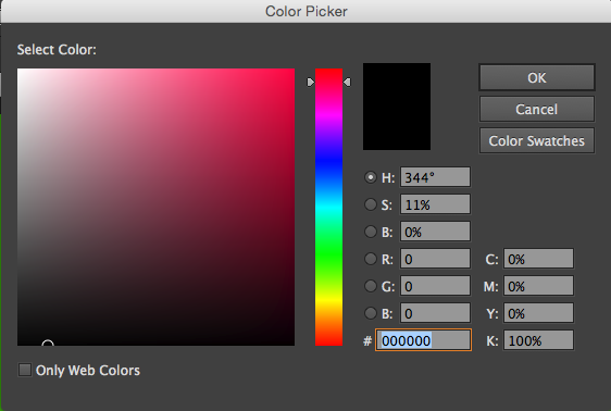

For some odd reason now it is saying that the 100k is also the hex #000000. Do you guys know what in the world is going on now? I might have messed something up in the color settings when I was trying to figure this out before but I did the shift+option+cmd keys and I think it reset the preferences but it still says that 100k is #000000.

Jun 24, 2015 Jun 24, 2015
Changing the Document Color Mode doesn't convert the pre-existing objects in the file. You must also Select All, then choose Edit > Colors > Convert to CMYK. Stop worrying about the reported hexadecimal values.
Well, I wasn't really setting forth anything I'd call a rule-of-thumb. It's certainly understandable when you perceive a discrepancy that you start looking everywhere for logic, or the flaw therein. But in your case, I believe you had simply missed the actual conversion of pre-existing objects (or more accurately, their colors),  to CMYK, and your attempt to use the hex value as a reference only clouded your perception of the problem and led your thinking farther from its true nature.
Directly to your questions, I would say yes, don't pay attention to the hex values when using RGB or CMYK mixes, but that's not to suggest the hex values would be misleading if you did; just that they didn't help when you were already mislead without them.
