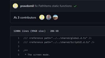

Well just try this: make a new folder, then open that folder up with VSCode.
YourFolder/AdobeTypes/index.d.ts
YourFolder/AdobeTypes/JavaScript.d.ts
... and so on
Put the types for adobe .d.ts files inside it.
Make a new JSX file and at the top of this file write the following:
/// <reference types="./YourFolder/AdobeTypes"/>
When you put no semi-colon at the end of this, VSCode will better highlight the file path and it will tell you if the path is missing. Unfortunately, for me, VSCode does not auto-complete the path in this statement like it does with some other things. At least it tells you when the path is wrong. In types for adobe files you can also see the reference statements being included, they help bring in the other types files. For example, Illustrator-stuff index.d.ts contains reference statements that bring in code from JavaScript.d.ts and global.d.ts, etc.

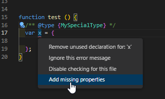

You then can use JSDoc. Since an Adobe types file contains the "app" variable declaration, it will now know when you type in "app.activeDocument" that it's an Illustrator document and you can auto-complete the properties when you write all the code. You can also put in special comments such as:
/** @TyPe {string[]} */
var stringArray = [];
alert(stringArray.length);
