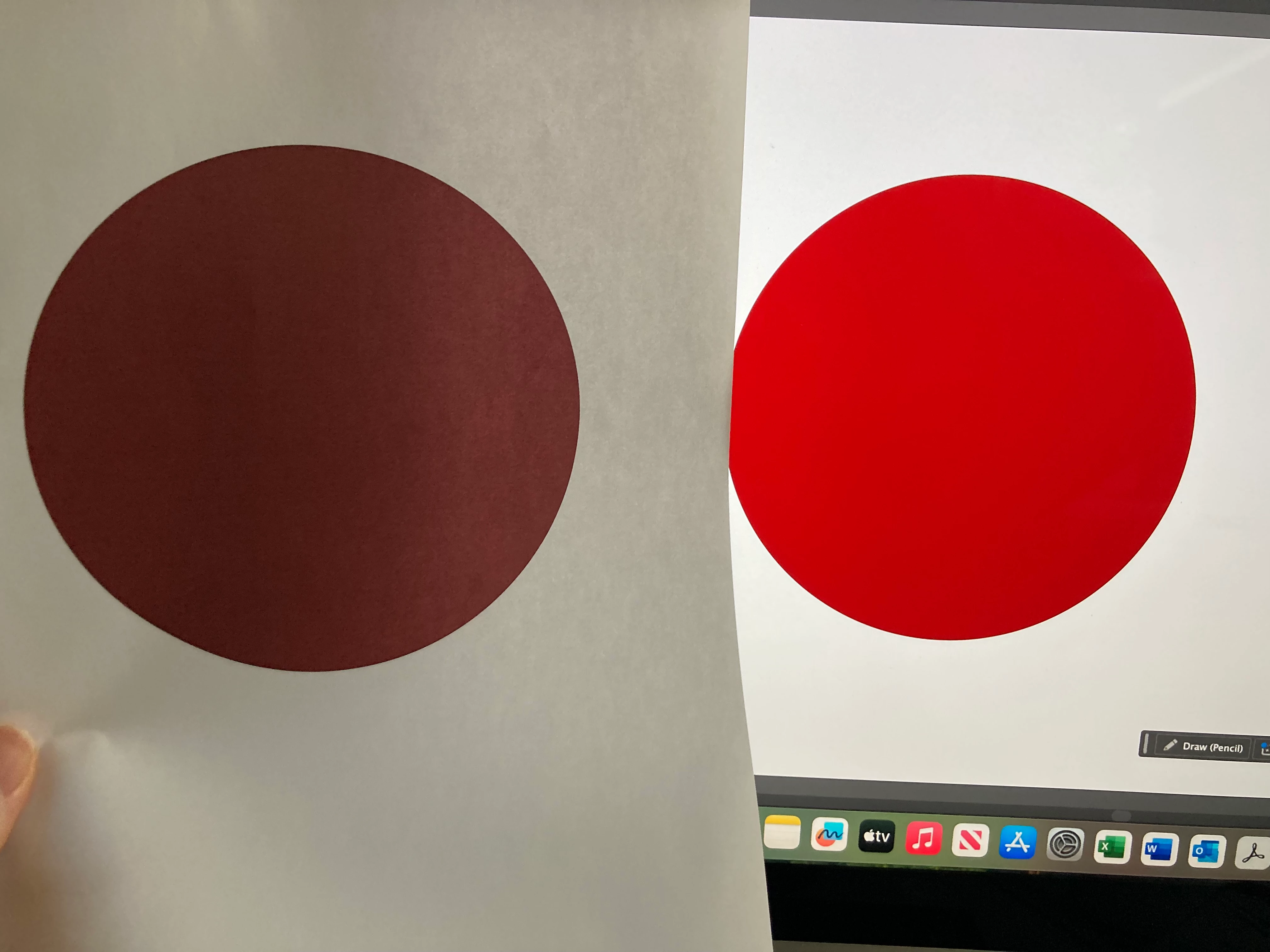

I am using Illustartor 2025 and when I go to print, the colours are very desaturated. The Red prints out as more of a burgendy colour.

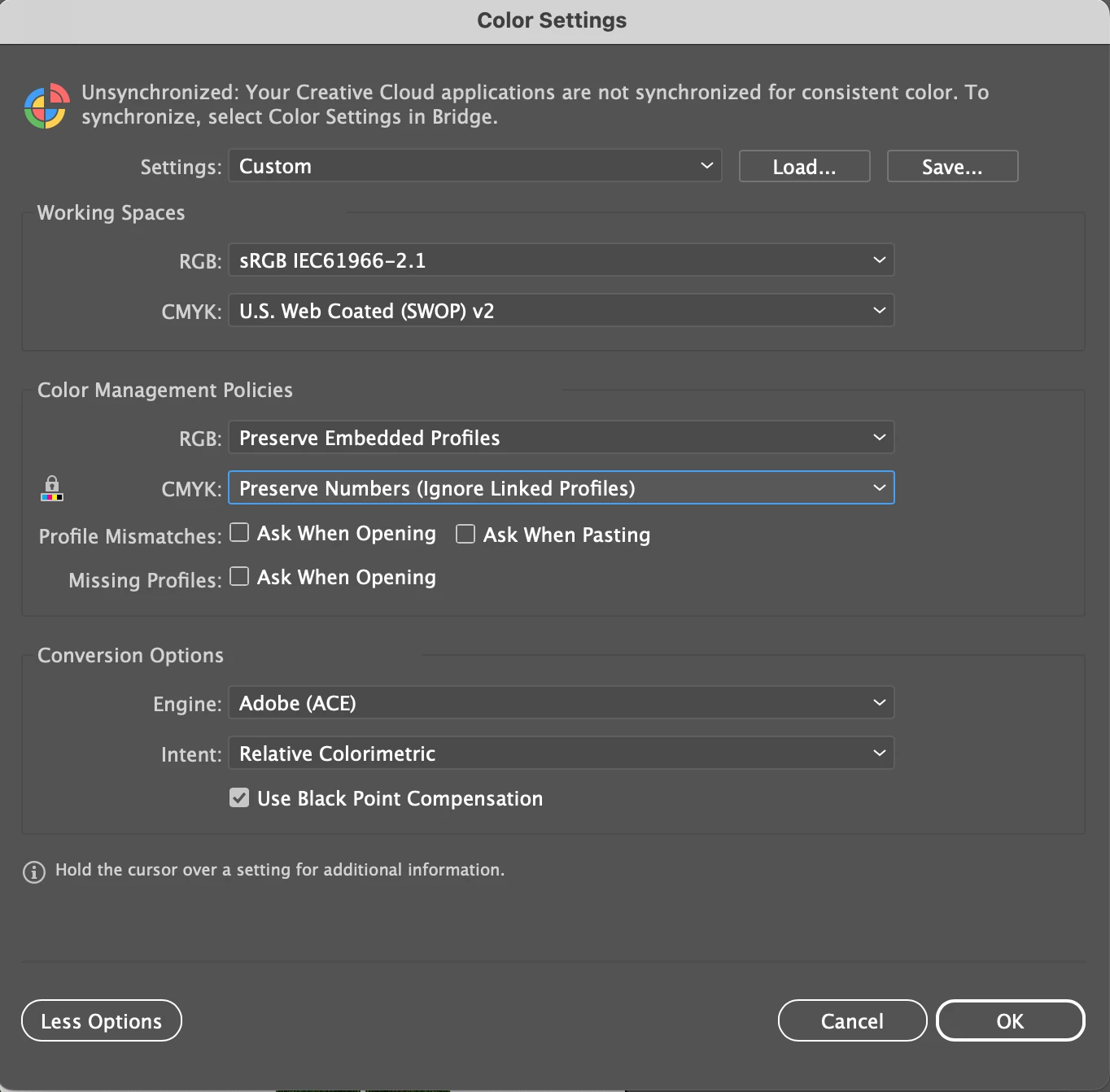

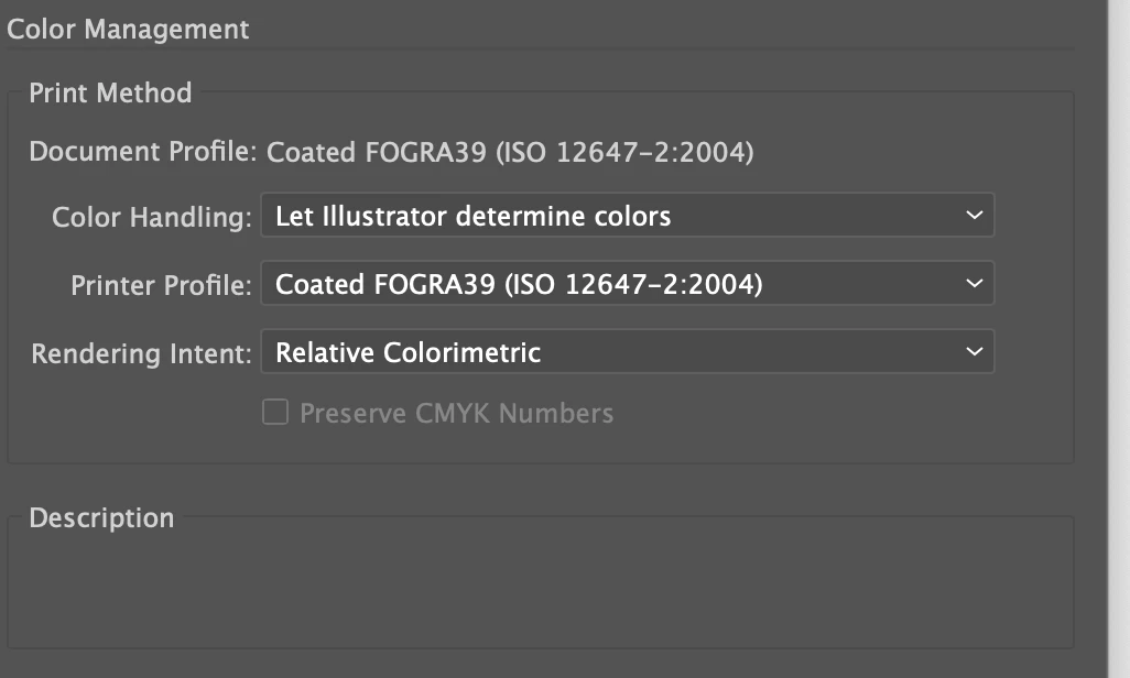

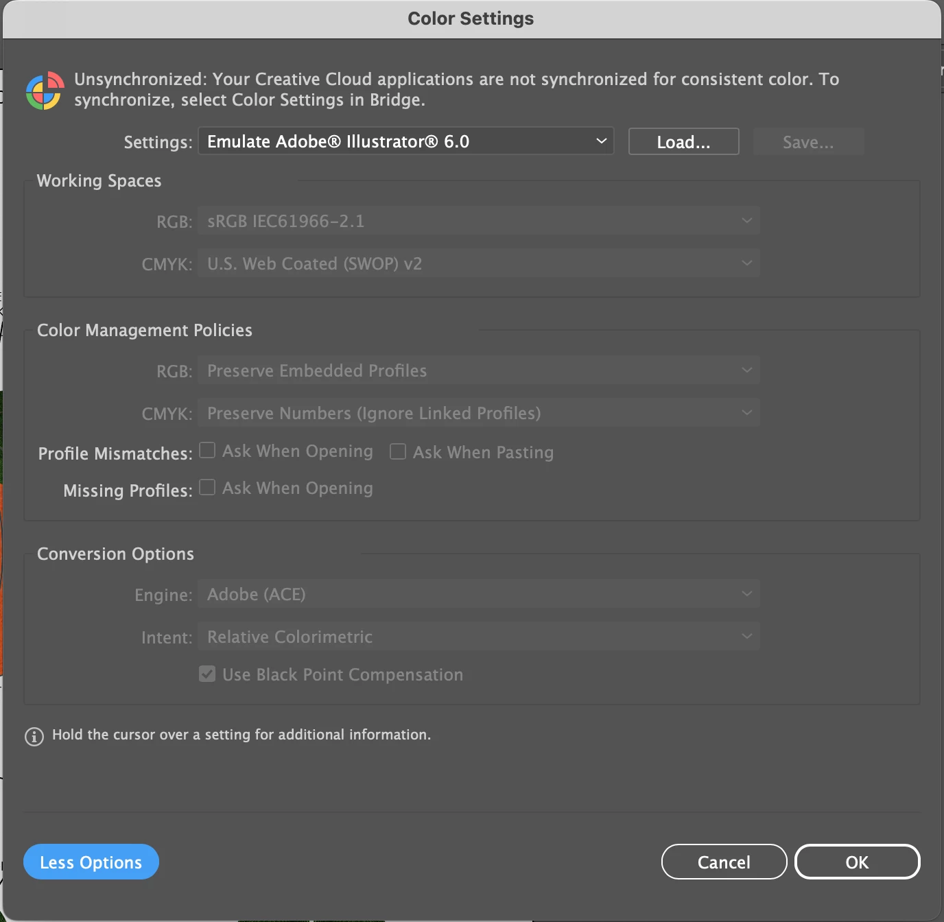

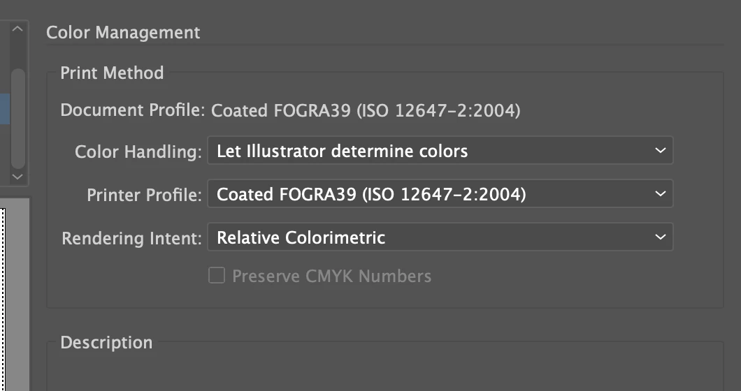

We have tried both CMYK and RGB and they almost identical. All other colour settings seem to be greyed out.
I don't really know much about the colour settings or what could cause such a difference in colour between what is onscreen and what is being printed out.

one more thing, if you check the color management settings in acrobat pro and use the same setting are you getting the same result ?

We did try the color management and it's the same result.

The paper you are using looks like some cheap office paper.
Also: if this is an inkjet office printer, it will give better results, when you send RGB data to print.
What kind of printer is it?
Did you already read the documentation and how to turn off its own color management?
