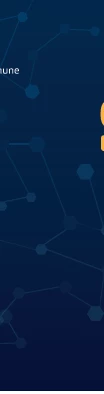

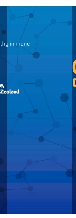

I saved a print file in pdf format via Illustrator and I opened it on my end and it looks great, but after I have attached it to the email, I suddenly have a lighter block of colour in the middle and the gradient looks really bad. The colour looks different too.
What it should look like:
What it looks like after attaching it to the email:

So I saved as high quality print via Illustrator. I mean... there's layers on there but there's no transparency, the whole artwork is backed on a gradient background colour.
I'm not sure what you mean by the question here. It's what I'm used to doing, it's what I was taught to do back in design school, to save as a pdf. I use the crop marks function as there's bleed. I tried to send them an eps file but they said "we can't open this file".

Actually I do use Acrobat. Funny thing is, when I use Acrobat to look at the file after downloading it again from my email it looks absolutely fine. But this has never happened to any of my other files in the past.
Below is a preview of the email in gmail, left pdf is saved as mentioned above, right is saved as a tiff first.
