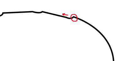

I use the latest Illustrator version 28.5 on a Windows PC.
I created a shape using the Pen tool. It should be connected like always (Image 1 attached) but when i zoom in the dots seems disconnected (Image 2 attached). I use the lines for a CNC cutting machine, the cutting software doesn't read it when it's disconnected like that. What's the problem with Illustrator, I had no issue before.

Thanks for sharing the file with the markers. I can see the "issue", but it seems to be just a display conflict between the edges of the path and the direction handles when extremely zoomed in and when the Selection tool (black arrow) is active.
Nonetheless, the path is closed, though it may look a bit weird.

As a test, I exported an SVG and is has a proper closed path command (Z), so it seems fine here.
May 21, 2024 May 21, 2024
That being said, SVG is a much cruder way of defining objects than in an Illustrator file. Whereas Illustrator defines objects with absolute positioning, (i.e. start at point 100,100... them move to point 103,104 and connect with a line, etc etc), SVG positions things relatively (i.e. start at point 100,100 then move 3 points to the left and 4 points down, connect with a line, etc etc) . How well it does that depends on the decimal precision you saved the SVG at. In your drawing, your path starts at this location (circled in my screen grab) and draws counter clockwise from there. In SVG, it places anchor points relative to this starting point, eventually making it back around (hopefully) to the same starting spot. The end point might actually fall ever so slightly away from the starting point, so the SVG closed path command might draw a very tiny line to join the starting and end point that wasn't in your Illustrator file. This tiny line could actually back up on itself which I can see can play havoc with a CNC machine. This "extra" line did show up in the exported SVG I made (precision 3)
