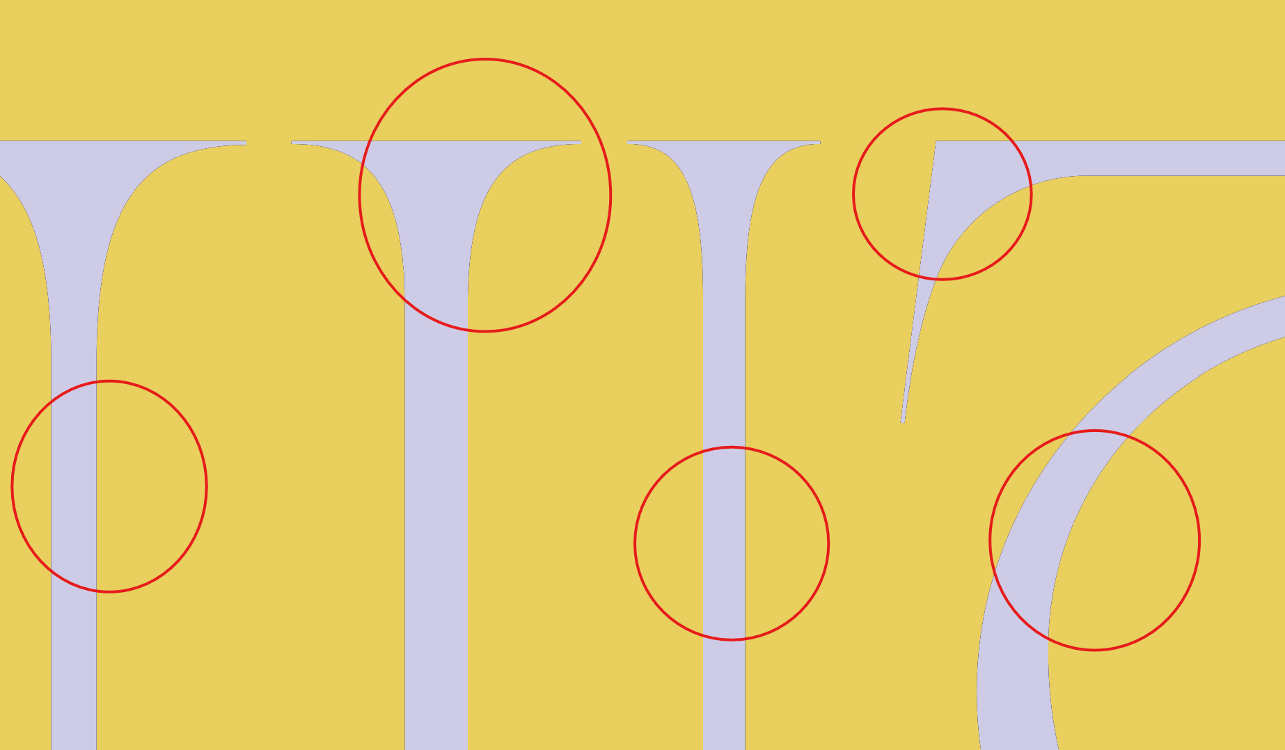

Community Beginner ,
Sep 24, 2025 Sep 24, 2025
Hello Anshul, I am still having issues with this problem. I have switched to CPU preview mode, exported to JPG and PDF, and made sure my Graphics Driver is up to date. The small stroke is still present. Can you please provide an update for a possible solution? Screenshot has been attached. Thank you.
Is this live text? If so, try to first select the text with the text selection tool (T) and fill it with none.
Deselect it.
Then select the text with the selection pointer (V) and fill it with the color you like.
I think what you're seeing is a path rendering glitch on screen. If a path segment is bending between two anchor points in too much of an awkward or demanding way those rendering glitches can occur. I'll sometimes see errors like that when I'm manually drawing paths and adjusting the anchor points. Instead of the line stroke being uniform small portions of it will thicken and even flatten into a polygonal appearance. The glitches are just visible on screen; I haven't seen them print (my experience may differ from others). But the glitches are still disturbing to see. One solution to the problem is adding one or more anchor points along the curve between the two original anchor points. That will make it easier for the computer to render the path on screen.
Oct 01, 2025 Oct 01, 2025
So I figured out the issue. Due to the shapes in question belonging to a group, which were emanating from different steps in the creative process, there were multiple appearances within the group that were not matching according to the Appearance Panel, even when changing the Fill Color to the group as a whole. The solution I found was going into the group in Isolation Mode and clicking "Clear Appearance" in the Appearance Panel dropdown, and then selecting the entire group outside of Isolation, and choosing the desired color. This removed the odd stroke that was present in my previous screenshot. Thank you for your assistance and I hope this helps someone!
