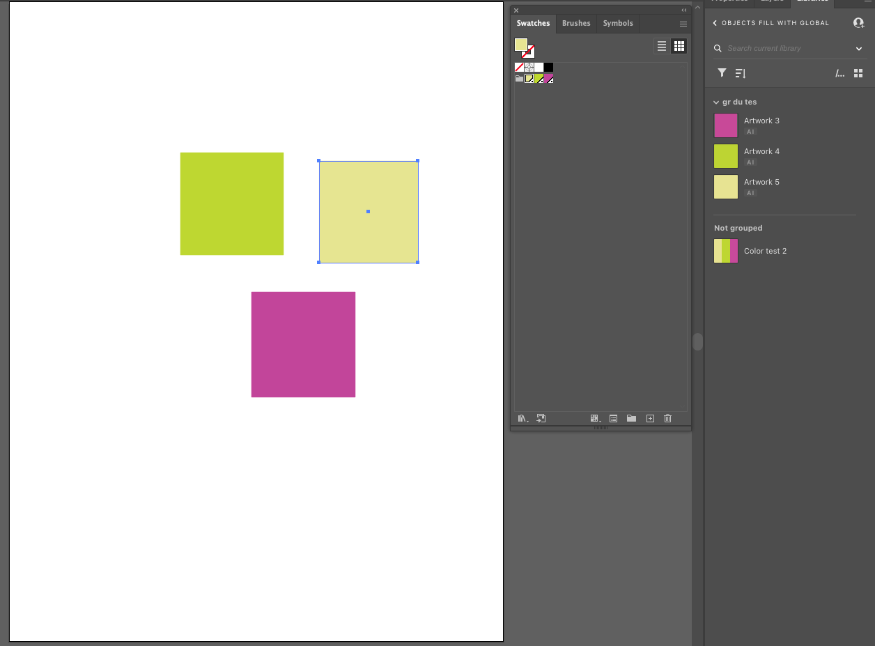

I created a new library in my Libraries (illustrator 2023) consisting of a lot of color group (5 elements each).
When I want to bring back a color group in my Swatches palette, I right click it to go to "add then to swatches".
Here is the bug; only the name of the theme is added in my Swatches, an empty folder with the correct name that is all I
am able to produce.
Any ideas how to procede, someone ?

You have process globals, so alt drag your graphic form library to canvas to bring is a vector paths, rather than a link to library.
Alternatively, you could make spot colors prior to adding as a graphic to the library. This holds the name of your global color. So that is fine for RGB work, but if you are doing CMYK print you will need to convert your colors to CMYK.

I can reproduce that behaviour.
Are these Global Swatches?
When you create a rectangle and click on a color in the library, does it add the color?
April 24, 2023
Hi Tom.
Yes these are Global Swatches, the default now when you create a swatch.
No I can't clic on a individual color in this library. It is a collection of color group.
jr.
Ton Frederiks
April 24, 2023
There are problems with CC libraries and Global colors (for years).
When I click on a global swatch in a group in a CC library, it does not fill a selected object, but it creates a magenta Spot color in the Swatches panel.
