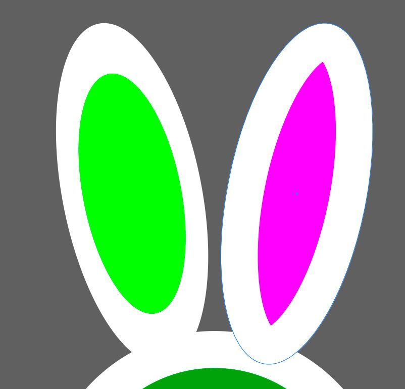

I'm trying to do inside offset on an ellipse but when I do it I get pointed ends on the ellipse.  Only way I could do it was to scale down my ellipse to size of inner I wanted then do outside offset.  Is there a way to do it by doing an inside offset?  Duplicating and scaling of course doesn't do it.  What's the correct way to accomplish this?  Thanks

The pointed ends inside the oval is just a consequence of geometry. The offset path effect creates a new path at a consistent distance parallel to the existing path. Pointed ends will always eventually occur when the offset setting inside an oval path is made large enough. Creating a smaller oval rather than just using the offset path effect is one work-around, but the distance between the two paths is not uniform. Another work-around is manually editing the pointed ends or using a corner filet effect tool. A number of Illustrator plug-ins out there will do it.

Thats cool but it isn't symetric  I want it to look like this on right

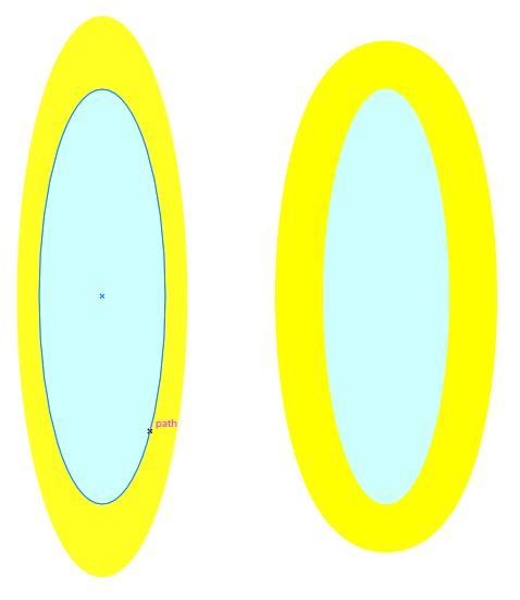

yeah its pretty close but I guess it's just another technique to do it.  Still looks a little different from the one that is offset on the right from the inner ellipse
Feb 21, 2020 Feb 21, 2020
You can do the offset path, and then use the corner widgets to round off the points

thanks, I forgot about those.
