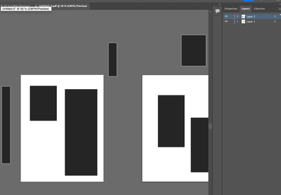

I know how to save artboards to PDFs and remove pasteboard (off-artboard) conent. I'd save a PDF 1.6 with Preserve Illustrator Editing Capabilities unchecked. But this gets rid of my layers when reopening the PDF file in Illustrator.
I also know how to save artboards to PDFs and retain the layers. I'd save as a PDF 1.6 with Preserve Illustrator Editing Capabilities checked. But this file includes all of the pasteboard content when reopening the file in Illustrator.

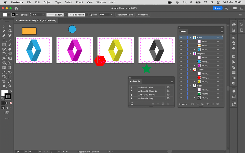

There is a file with multiple artboards, each artboard has one or more layers and outside the artboards there are objects.
Saving the file as .ai with the "each artboard as a separate .ai file" option keeps the layers in each file and gets rid of the content outside the artboards.
Ton Frederiks
March 3, 2023
Examples:
