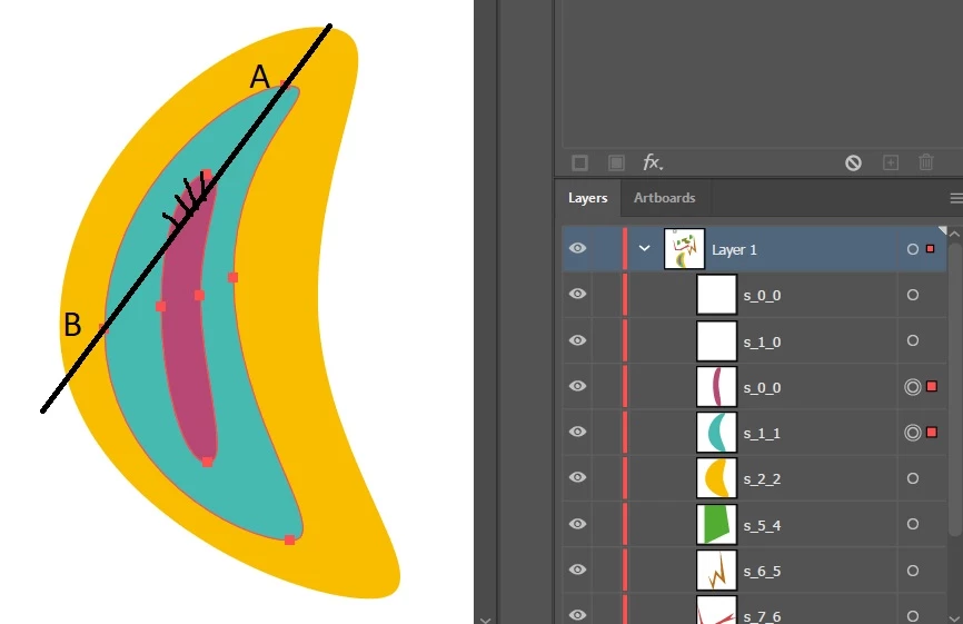

I’ve a Illustrator design with curved and nested shapes. I’ve created JavaScript for Illustrator to identify if a shape (foreach) is lying inside another shape, it is based on the algo posted by 56ka in post java - Algorithm to verify if a shape is inside another - javafx - Stack Overflow but I realized that it doesn’t work for curved shapes ☹ because this algo assumes straight lines between anchor points, see picture below where algo fails for checking s_0_0 inside s_1_1:
I wonder if somebody has overcome this type of problem for Illustrator JavaScript for design with curved and nested shapes if yes can share the used algo?
Thank you in advance for your help!
CarlosCanto
CarlosCantoCorrect answer
January 11, 2021
I posted the algorithm to a possible solution in the link provided above.
here's what I suggested back then
"what if we have two paths, select them both and do a Path Finder Unite operation?
...if we end up with a group, the test path is outside of the Container path (the Ellipse)
...if we end up with the exact same path as the Ellipse, the test path was fully contained inside of it
...if we end up with a path "different" than the starting Ellipse, then the test path was partially outside
no math required."

Hi everybody and thank you for your replies and your time!
When looking at the proposed (sophisticated) algos I’m concerned about the processing time it would take to process all my shapes (>1000 in my current design, my code is currently not performance optimized). In the end, with your feedback, I’ll accept/ deal with the few exceptions for which the ‘standard’ ray-casting algo doesn’t work. Thank you again for your valuable feedbacks!

@HiroyukiSato Thanks for writing such terrific scripts! 🙂 Hope I haven't made too much of a mess of the above modification.
- Mark
m1b
January 10, 2021
Interesting problem. My first thought is to cause the script to approximate the curves with small straight line segments, by using say, Zig Zag or Scribble or something like that, with settings that add anchor points but don't actually deform the path. Another idea is to modify Hiroyuki Sato's script Divide to calculate the points for you. Then you'd be able to run your algorithm.
I'm interested to know how you go, so please post back if you get anywhere with it. Also wondered if you'd like to post the algorithm you ported from Java? - Mark
