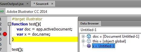

I believe you can double your productivity by using the step-through functions of the ETSK and watching the data browser for the contents of your variables.  When you do, a new world will open up!  You click the area next to your line number to set up a breakpoint and use the shortcuts under the Debug menu to go through your script, seeing the innards.  In the case of this screenshot, I pressed Run, and it ran until reaching my breakpoint.  At this time it is possible to see the variable x in the Data Browser, it shows to be a string "Untitled-1"
Jan 08, 2015 Jan 08, 2015
DDo you know of any good tutorial video that walks through break points and step through functions??? I've seen all of that stuff there, and I've used the data browser to view the values of certain variables and sometimes I've been able to discern available properties that weren't listed in the scripting guide. But the data browser is always so cluttered with stuff that is in no way relevant to my project (tons of after effects functions????) and I haven't quite seen how to delete the impertinent stuff.. I just need some kind of crash course.. But I can definitely see the benefits you're talking about and how they woudid really increase my productivity.
Valorous Hero ,
I see.  The reason you see too much clutter is because of a lack of closure.  See my screenshot above, the code is wrapped in a function called test().  When you're running scripts without a closure, you add all the variables you've created into memory and you will see them next time too.
Try to run the exact thing I have in the screenshot, and you should only see the variables in the screenshot.

Yes there can be a lot of stuff in the global scope when you're just in the etsk writing your script, but when you step-through  (Debug > Step Into), your variables in the data browser should only be the ones in the current scope of execution.

Your yellow line is at the start of the function, before your execution goes inside, so it shows the old global stuff from outside.  Press F11 on Windows or Shift+Cmd+I on a Mac to step into the function.  Your yellow line will go into the function and your data browser will show just stuff in the function.

The breakpoints are what will help you get somewhere faster without going through a bunch of code manually: you put one on, hit debug>Run and it will stop at the breakpoint, if something is there.  That way you can see what different properties are in something.  It shows the data in the data browser on the next line because it shows stuff for lines before your current one.  When you do another step, you read the line your lellow line is on for the first time.  I wanted you to know about this because you were having problems with the fillcolor of a path item, and the spot color, which is confusing still to me after all these years, but you can see exactly what you are up against when using breakpoints and stepping through.  For stepping over functions, you can use the Step-Over command to skip a block of code.  What I generally do is put my breakpoint, hit Run, it stops where the breakpoint is and then I either abort execution or hit run again to finish after I've observed what I need.  Most of the time, I do use $.writeln and alert() to get quick info, but when something is not working and you don't know why and are going mad, this may be the only way to save oneself.
