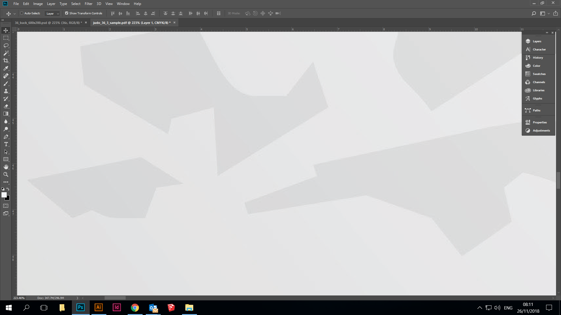

i'm building sings at illustrator and linking an RGB background, jpg file (to an CMYK file), and when i export to PDF file and check it on Photoshop - the background gets pixels that is not there when i open the jpg background alone on Photoshop.
it seem that this software passing destroy a bit the file, and that it is better for me to build it on Photoshop so it will remain clear, with out and pixels.

that is what i donw, see bleow - the first screenshot will be the jpg on Photoshop:
and this after liked to an illustrator file ans export to pdf:

Ok, I can see that you've opened the PDF in Photoshop. Instead, open the PDF in Acrobat as Monika said. When you import the PDF file in photoshop there will be bluriness. Better you check the file by opening in Acrobat.

The second screen shot clearly shows JPEG compression artefacts. So JPEG has been placed then recompressed as JPEG.
1. Avoid JPEG in the page make up since you will be recompressing: use TIFF or PSD.
2. Check your PDF export settings, they are important - never just use the default.
