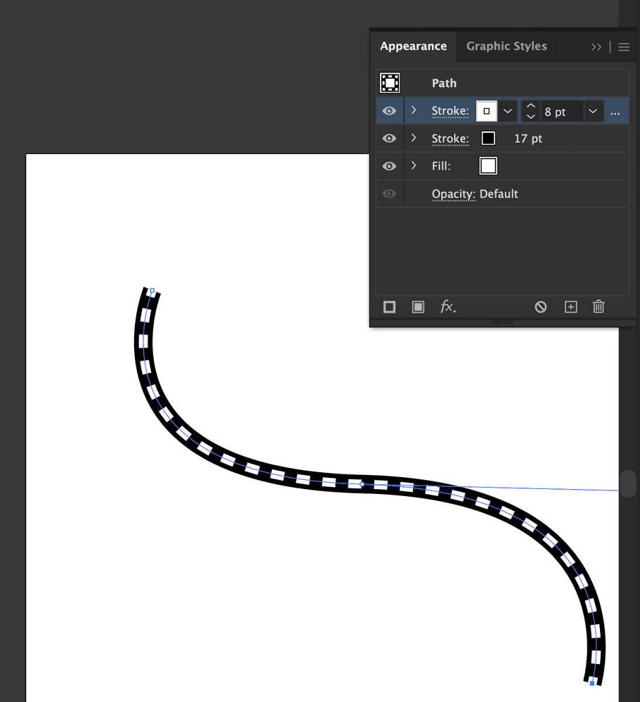

If your question is: How to make a dotted line on top of a solid line, follow the steps below.
  1. Make your solid line
  2. In the Appearance panel, select that Stroke listing and click the [+] button at the bottom of the panel to duplicate that stroke
  3. Make the new top stroke a smaller weight and a different color
  4. In the new stroke listing click on the Stroke popup panel.
  5. In that panel, check Dashed Line and you should get a smaller dashed line inside of your original solid line.
  6. Make the setting for the Dash 0 and a much larger number in the first Gap field
  7. In the stroke popup panel add a Round Cap
You should end up with a dotted line inside of a solid line.
To make the dots further appart, increase the Gap amount
Hope this helps!
See attached screenshots.
