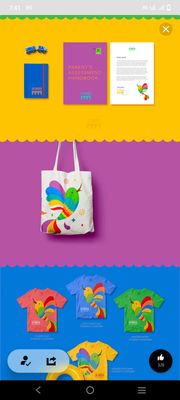

I need to get a logo done in 5 different sizes: extra small, small, medium, large and extra large.
See attached picture for an illustration of the logo style.
