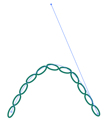

This is what the scatter brush gave me. Maybe I am creating the brush wrong?
Oct 01, 2024 Oct 01, 2024
In the Scatter Brush Options dialog you can set the rotation relative to the path (instead of the artboard). Try that.

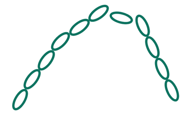

Thanks. It sort of did what I wanted but not quite right.
This is the closest one:
If I continue adjusting more, it became distorted like this:

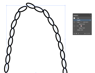

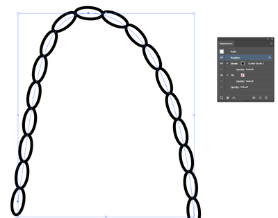

Try applying a Roughen effect with a size of 0. It should even out parts like that, especially at small sizes.
Without Roughen:
With Roughen:
