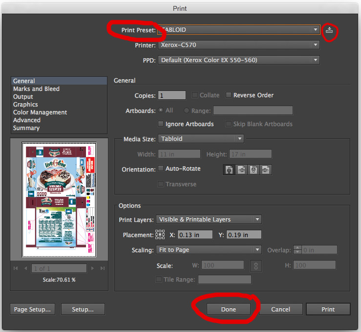

What happens if you
  1. update your settings of rho you would like this to print
  2. click the Done box at the bottom center of print window
  3. save your document
The settings are saved with the .ai file, and will hold on this machine. If you open on another machine and have the same exact print driver/OS setup they would show there the same, or else you will get the defined by driver.
If you use these settings often you can click on the top right of print window on the arrow over drive icon, save your settings, they will then show as the name you choose under Print Preset (eg: TABLOID)

Have you tried locking in your media size with creating a print preset as I suggested. Many people miss making print presets, but they are very handy, and can save a lot of scrolling around in menus.

I did create my own print preset and that helps but it still seems to be a workaround.  The preset itself still does not seem to stick.  What is happening is that the print options seem to always be reverting to the "default" preset that illustrator provides.  So the biggest improvement I had is to edit the default print preset to my settings.  Now when it changes to default it at least changes to my settings.  But this is still a workaround because sometimes I want to use the original default print settings.
