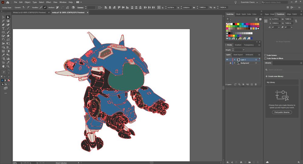

Can you show a screenshot of your workspace with the object selected and the layers panel visible?

whenever i try to select one portion of my project it selects the whole thing for some reason too

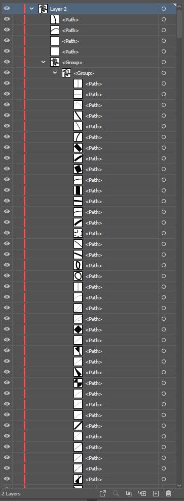

You need to show what's inside the layers and group.
Also: we don't know what is "metal" in your artwork.

Sorry, it's late, my descriptions are garbage right now lol but whatever is blue on the mech is metal, and the greenish round color object in the direct center is the glass. Most of the second layer is path's, some say compound paths thoughLayer 1.jpgLayer2.jpgLayer 2 continue.jpg
Oct 02, 2020 Oct 02, 2020
Compound paths won't work with the mesh tool.
