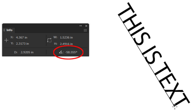

Good morning everyone, I have a silly problem but I can't find the solution. I need to reflect a text on the y-axis of an image while maintaining the readability of the text. I can reflect the text without any problem but after that I get stuck because I should reflect it again to make it readable. I know that the description is not easy to understand I leave you three images to explain better.
P.s. I could do it by hand but these are graphics that need to be printed for a motorcycle and I would like to be as accurate as possible.
Thank you very much.
Correct answer John Mensinger
The fact that the text is diagonal is what makes this less than straightforward. The trick will be making the angle known, if you don't already know it. For that you can use the measure tool:
Next, make a copy of the text and rotate it, rather than reflect it. (I would still reflect a copy as you did in your example, then use it as a "helper object" on which to align the properly-rotated text, then delete.)
The amount of rotation should be 180° minus the angle measured (or known).
In my example, I measured 58.555°
180° - 58.555° =  121.445°
With the text selected, double-click the Rotate tool and enter 121.445. Click the Copy button. The new copy will be rotated the correct amount, around the baseline anchor.

John MensingerCommunity ExpertCorrect answer
November 16, 2021
robypisco
robypiscoAuthor
November 18, 2021
Thanks, this is definitely the simplest and most correct solution.
