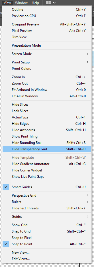

Ashutosh_Mishra
January 7, 2020
Hi there,
Thanks for reaching out. Please click on Hide Transparency Grid option under View menu. I am also attaching a screenshot for your reference:
Hope it helps. Let us know if you need more assistance, we'll be happy to help.
Ashutosh
casinclaire
January 8, 2020
Hi. It was a good try, but the transparency grid wasn't turned on. I never use it, so would have been surprised if it had been. Not even sure what it's for, to tell the truth.
