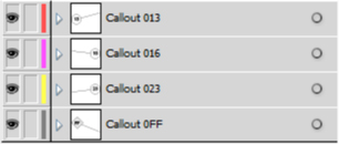

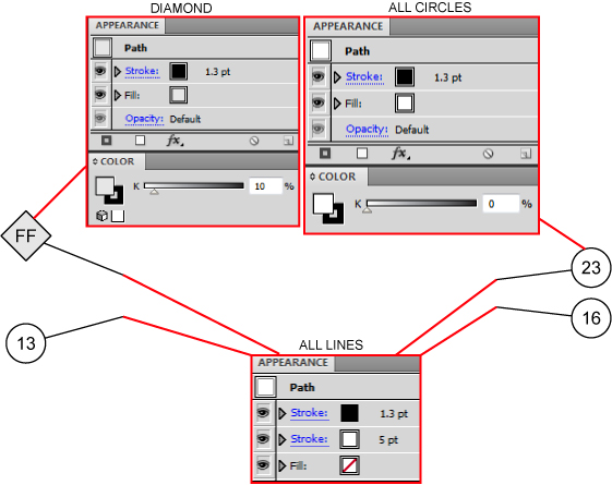

There is always a circle and a line behind each text item. They look like this....(I have included screen shots of the objects properties)
I am wanting my script to recognize the location of the items that overlap the corresponding text and after it creates the layer just send it all to the correct layer. So text object 13 would create the layer and the circle and line that are with it would go to the layer Callout 013. These items are not grouped. I am moving them manually right now but the volume I do I thought I would ask. This could be way too advanced and if it is I will continue doing it manually.
Here is what the final layers would look like after the script ran...

Here is a layout of the steps I take.
1. I select the text objects
2. I run my script to create layers based on the selected text objects content and format the layer name to a certain requirement. Callout and 3 digits.
3. I select the circle line and text that are close and send to the correct layer.
So for an example using my picture above.....
1. I select number 13
2. I run my script to create my custom layer based on my selection and get a layer name Callout 013
3. I select the number 13 and the line and circle that are right there with it
4. I send those 3 items (#13, circle, line) to the layer Callout 013
Does that help?
