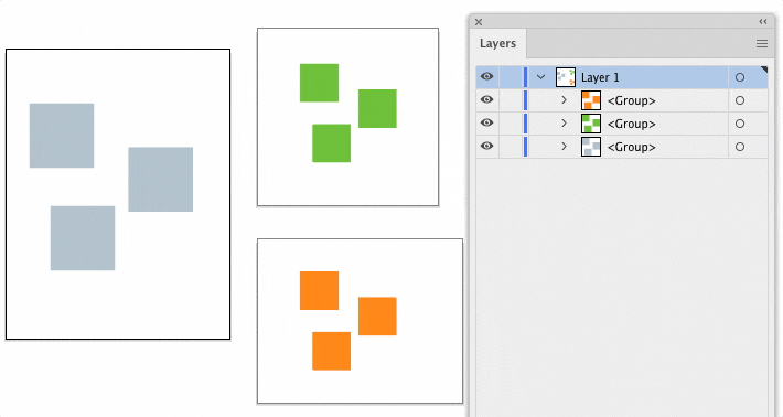

Explorer ,
Oct 16, 2022 Oct 16, 2022
Hey, here is the screenshoot before and after running the script. Thank you
Enthusiast ,
Oct 17, 2022 Oct 17, 2022
I understand the problem. An old Adobe bug where objects on the artboard are selected before the script runs and then re-selected by the script. Added a fix. I also made a new layer name from the artboard name.

Explorer ,
Hey thank you, this works perfect 🙂
