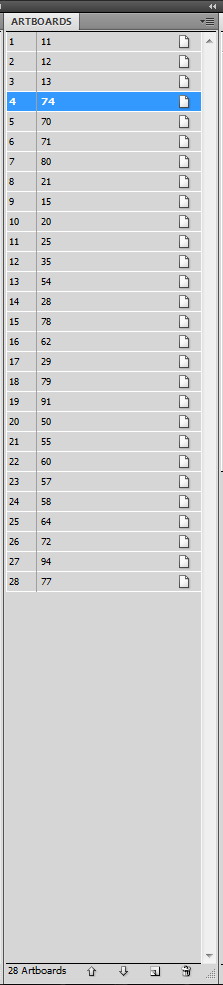

Feb 06, 2011 Feb 06, 2011
can you post a screen shot showing your Artboards palette?
Explorer ,
Feb 07, 2011 Feb 07, 2011
No problem.  Just curious, do you have another idea?  Does my previous post make sense?
