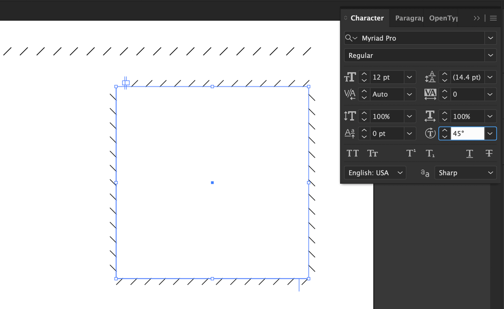

Hope someone can help me. First I am new to AI but not to PS so I have half a clue maybe.  So…. I do leather work and am starting to create my patterns in AI. No problem with the shapes and the like but when I go to add a stitching line, I created using the pattern brush and apply it to say a box and then to a different sized box that would be sewn together the stitching spacing doesn’t match up. So I guess what I am trying to say is I need my 2mm high 45 degree diagonal lines that are 3.38mm apart from each other (that’s the distance between the pricks on the pricking iron)  to stay that way no matter what the size or shape. Make sense?  I know it can be done I see it on other patterns. Any help wouyld be greatly appreciated. Thanks in advance.
on attached picture to differnt sized squares and you can see how they start to offset on each other. thanks the problem.
Correct answer Don Gatto
cool.... I will give this a shot and let you know thatnk you!!!!!
Jeff wanted to get back to you that yes the Type on Path Tool is working combined with the Path Options Spacing. I can do this on any shape with the proper distance between my 45 degree marks. Thank you for your help. Thanks for hanging in there with me to figure this out!!!
Sincerely,
Don

Thank you!  OK I went and took the pricking iron to the scattered pattern and its still off, see picture. I am not familular with the settings like how % correlates to distance apart etc... Any additional help would be great thatnk you

Try the scatter brush instead of the pattern brush
