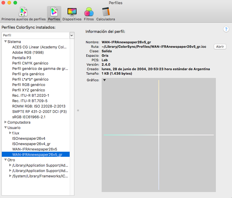

Hi guys,
I am doing a newspaper ad for a black and white press. I talked to the newspapers and the right color profile is
WAN-IFRAnewspaper26v5_gr.icc
I did double click on the color profile and it did install it all right in Mac environment.

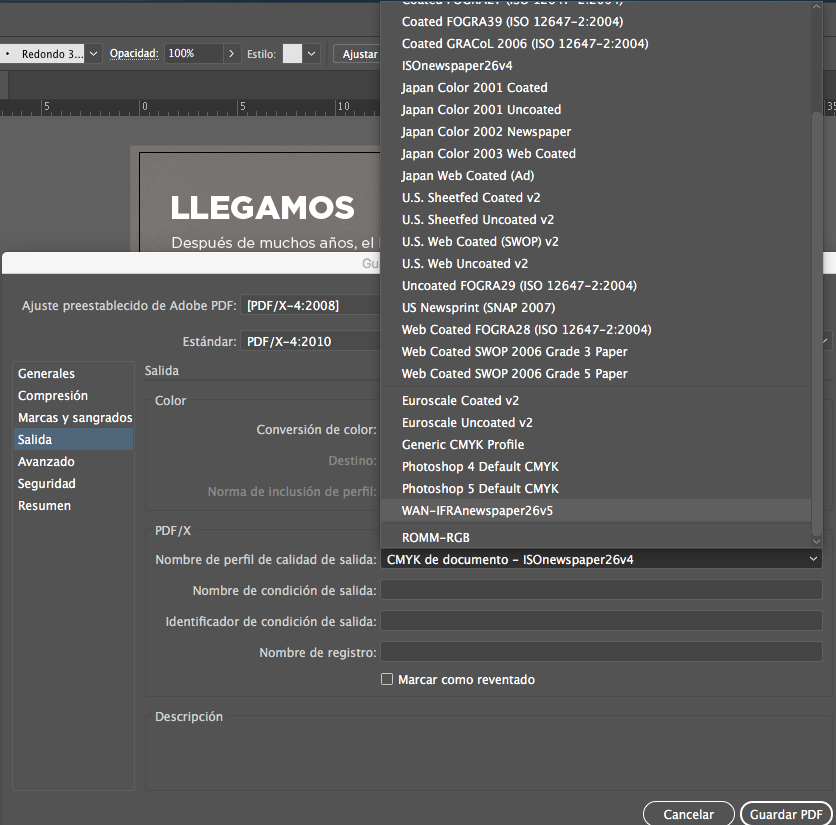

However when trying to save as PDF from Illustrator that color profile is not there. The only available is the
WAN-IFRAnewspaper26v5.icc
but this is the COLOR version for newspaper.
Funny that the same color profile for grayscale it does appear all right in Photoshop and InDesign when exporting or saving as.

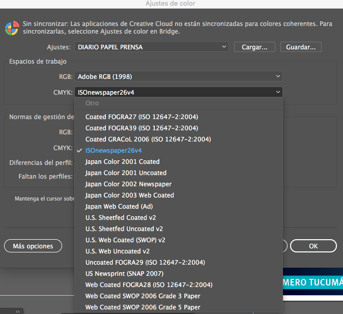

By the way, from time to time, Illustrator's color profile do not stick and change by the default mode which is Emulator Adobe Illustrator 6.0 and is not a good choice for printing. I don´t know if i should re install Illustrator or reset Color Profiles in Mac (i don´t know how to do it)

As for your problem with Illustrator setting color management to "Emulate Illustrator 6": this should not happen. You might try if it's a preferences issue. You can rename the preferences folder, thus forcing Illustrator to create a new one when you launch next time. In case the resetting continues to happen and you want to revert to your old preferences, you can trash the newly created folder and name back the old one.
As for the embedded profile: to which kind of PDF are you exporting?
What else is in the file? Do you need to convert to profile because of embedded raster images? Or is there just vector content in the file that shouldn't be converted anyway?

I am trying to export PDF/X-3:2002. The newspaper gave me the settings.

Illustrator doesn't support greyscale mode like Photoshop does, and therefore doesn't support greyscale profiles like 'WAN-IFRAnewspaper26v5_gr.icc'. Your safest bet is to work in CMYK mode, assign the CMYK 'WAN-IFRAnewspaper26v5' profile, and make sure you only use tints of black. You can check this while you work using the the Separations Preview palette, unticking the black separation to make sure there's nothing on the CMY separations.

By the way, are you familiar with the Mac OS environment for color management? I did double click and install WAN-IFRAnewspaper26v5.icc (i mean the COLOR profile not the grayscale version) but is not available as an export option. in Illustrator. It does appear in InDesign and Photoshop.
Maybe if i trash where they are stored...
thanks again 😉

I tend to put all my ICC profiles here: Macintosh HD/Library/ColorSync/Profiles. In there I have folders for CMYK, RGB Working Spaces, Greyscale, Monitor Profiles etc.
That makes them available to all applications, for all users (not that there are any others on my work machine).

As Danny mentioned, Illustrator does not have greyscale mode.
But you can convert your PDF in Acrobat to your grescale profile.
