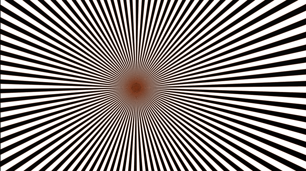

If someone can help me create this in illustrator that would be amazing!! I am not concerned with the folded corner effect.

Draw the line with the same thicknes from the centento the edge, then use the rotate tool ( press R ) Then hold down
the alt key and click on the tip of the line in the center to set the anchor point, a dialog box will show up to put the rotation value insert any value ( 6 dgree) and click copy
then press ctrl + D

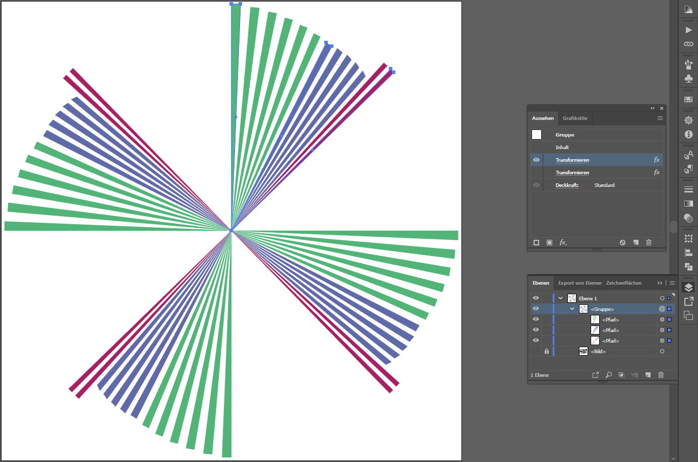

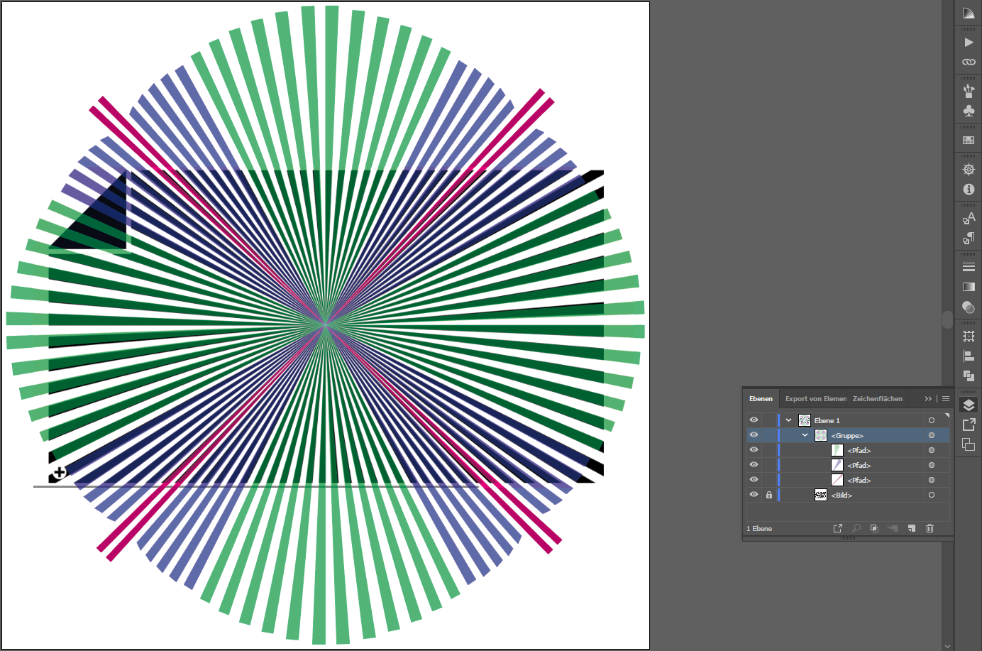

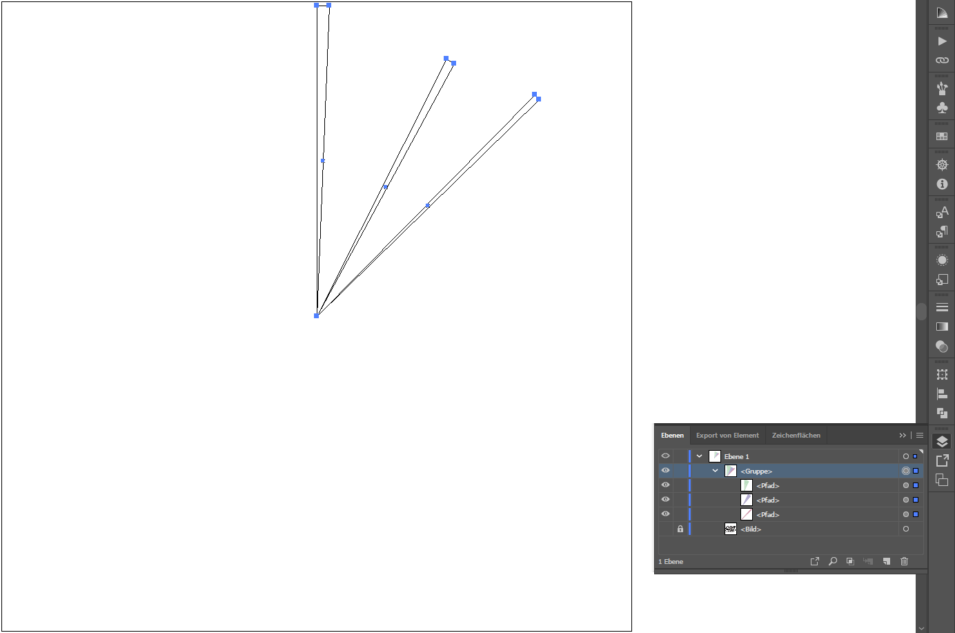

Another way - constructed, not drawn. (Ctrl+D or Transform effect with one triangle does not help in this case - because of every triangle does have another width! )
