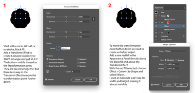

Aug 24, 2024 Aug 24, 2024
Let me add another one. This uses an additional fill in the Appearance panel as a helper object to position the circles. You need to zoom in a lot to eyeball the most accurate position. Live Paint and Pathfinder finish the job,
