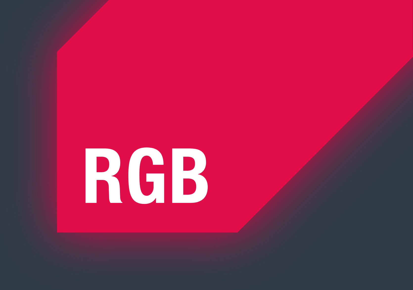

I am creating this graphic in Illustrator and InDesign. It is using an outer glow with the same magenta color as the fill of the shape. Normal blend mode 100% opacity.
I would like to get a similar glow result in CMYK as I get in the RGB version. I do know there are significant differences in the RGB and CMYK color spaces.
Still I was hoping there might be some tricks to achieve a less white glow.
I already found this thread. But unfortunately the solution isn’t working since I don’t have a black background.
Bildschirmfoto 2018-10-21 um 22.49.23.pngBildschirmfoto 2018-10-21 um 22.49.08.png

What color is your background?  Cannot really make a recommendation without knowing that.  I would experiment with different Blend Modes to see what works better.  You say 100%, but against what color?

Yes sorry for leaving that out:
RGB: #e40045 on #303c49
CMYK: 0/100/60/0 on 63/32/14/76

Need to mention that 63/32/14/76 is not really black but merely a dark blue.

Yep, I know but I never intended it to be black. It is a dark blue as seen in my screenshots and it has to be this particular blue.
As these are brand colors I can just slightly alter them to achieve a better glow.

I wonder if you could create two glows ( the first one would be White which knocks out of the Dark Blue, then a second that consists of your Red set to either 100% or Multiply ).  The other option would be to try some of the other Blend Modes on your original Glow.

I tried that already and it makes the color of the glow just a little bit brighter but doesn’t knock out the dark blue.

As you can see in the separation tables you will never get a good result.

If you create a white object that knocks out the background the result will be white. If you put a red radient (red to white) upon this you can use normal or multiply as blend mode with all the same results because your background is white.

If you could change your background to 0/100/60/100 you will see the desired result.
The outer glow creates a gradient form the background color to your object's color.
Your object has no C and no K but full M and a lot of Y.
Your background has lots of C and K but only little M and Y.
