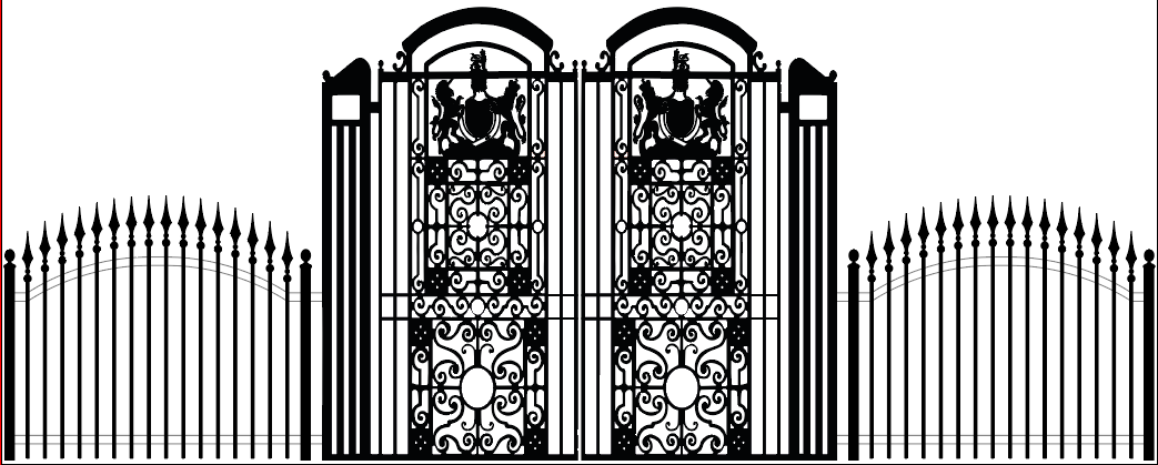

I am currently designing a complex vector of a fence/gate, which needs to be cut on simple black vinyl and then installed into an office on walls & lockers. For the vinyl machines to cut the vinyl out correctly, I need to create an overprint stroke around the vector and inside every gap that needs to be cut. Straight forward right? Well here's the issue.
I have designed the fence using different vector components and some of my own hand drawings and cant seem to get the outline correct. Whenever I group all the objects and use a stroke on the vector, it causes complications as it outlines my shapes/objects correctly but doesn't outline the lines that are actually strokes which makes sense. (See all images attached).
If I try to use pathfinder tools to create compound shapes, so it all merges, it just goes really funny. If you see the original designed vector and compare it to all the outlines I have tried, you will see the issues I am facing.
Now I really dont want to sit here and outline everything by hand, so is there any shortcut around outlining this?

You need to use the functions in the pathfinder panel to combine the shapes. Grouping is not sufficient for that.

You want them to stay this thin? Or do you want them filled in-between those thin lines? If the former: the strokes need to be outlined: Object > Path > Outline stroke. Pathfinders don't do that automatically.

So if I have a line, the line should have a stroke going around it, so the machine cuts around the line, making it a thin rectangle. If that makes sense.
Sep 13, 2019 Sep 13, 2019
Exactly. Vinyl is cut like that.
But you have to make sure that it matches the thinnest width that can be done. So the vinyl doesn't rip apart easily.

That is correct. Bare in mind the file I sent is a 4.5m file, so its not as thin as you'd imagine. Also, I tried the way you recomended and it worked however, slight issues again. I believe this is my mistake somewhere but I used blob tool to fill some gaps in and the outline, outlines them and also have shapes that are supposed to connect overlap. (See image link) https://ibb.co/pzBw0bZ

You have to combine those carefully and maybe even piece by piece. Check it in outline view. Seethat you delete invisible objects (no fill/no stroke). They might appear again after pathfinder operations.

If you have strokes and shapes, try Object > Path > Outline Stroke to turn them all into shapes. To combine your objects, you might try the ShapeBuilder Tool (Shift + M).
