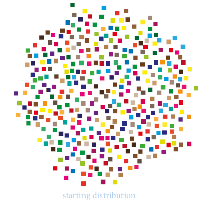

Hi @Hanschrs, this discussion inspired me to write a script that might help (but don't worry if it doesn't suit your case—I was happy to write it anyway as I've wanted to do something like this for a long time!)
The script is called "Distribute Items.js" and you can download it from my github repo for general scripts (it's a new repo, I just made today but I will be adding new scripts to it all the time).
If you try it out, try it on not-too-many page items to start with while you are experimenting with the parameters. If you like you can adjust the default parameters by editing the "settings" object in the script (it is near the start).
Let me know if it is useful.

distribute-items-1.gifexpand image

You already indicated that it's rather a good idea to not execute it with too many selected objects. As per my testing I'd say that one should definitely not select more than about 300 objects at the same time. Otherwise Illustrator gets severely frozen, at least on the machine I use at the moment.
Perhaps you should implement a warning message in case the users select too many crumbs.

Thanks Kurt, you are my best stress-tester! There is some bad code that runs slow that I will speed up and I will update the github when I've done that. Probably will be later today.
For fun, here is an animation showing step-by-step (ie. number of steps set to 1) after slightly increasing the radius. You can see what the algorithm is doing:
distribute-items-demo-2.gifexpand image
The algorithm is for spreading out the items, but you can make a tighter distribution by using a scale < 100%:
distribute-items-demo-3.gifexpand image

Hi @Kurt Gold just letting you know that I have updated the code on github. I have included text warnings, and alert warnings (for more extreme cases) and also added a progress bar, so you can at least know that things are working!
I would love to know how to improve performance further, but so far I don't have many ideas. I think now you can work on more than 300 items okay. Of course, if there are too many operations, you might want to stretch your legs and get a cup of coffee!

Mark, I tried the latest version of your script with various amounts of selected objects. So far, I'd still say that it is rather not recommended to use more than 200 or maybe 300 objects at the same time.
Using 400 or even more objects definitely freezes Illustrator for some time, but at least does not crash it and eventually works as intended.

Thanks Kurt. Yes unfortunately the algorithm is very processor intensive and ExtendScript is very slow. I'm not sure how I could improve the speed at the moment. Did you see the progress bar appear? That should give a steady time estimate so you know when you can go and do some gardening while it works away at the problem.
Now that I have fixed the initial bug you found, I'd be surprised if Illustrator actually froze or crashed, because it is really doing the same operations—measuring between mathematical points (not DOM path item points)—over and over again without storing them in memory. So if it can do one loop, it should be able to all of them without running out of memory. And it only touches the DOM at the very last minute (once the progress bar is full).
The settings are critical to speed, too. In some cases we can play with the parameters with a smaller number of items first, before applying to a larger number.
It is unfortunate that—due to the nature of the process—it doesn't work well to do a large number of items in smaller batches because the distribution will show flaws at the intersections of those batches.

Yes, Mark, the progress bar is displayed, but only after a pretty long time of frozen state (1 up to 2 or 3 minutes when using about 400 objects at the same time). Then the script dialog appears and it may take another minute to see any progress.
Then, changing any parameter in the script dialog causes further delays. Impatient people may not entirely be satisfied at that point.
Nonetheless, this script is very good. It just takes some time.

Oh wow! That is very different from—and much worse than—my experience on my machine here. Okay I've had a look and I think I had a glitch with my version control and lost part of a previous change. I have updated again and the time to come up to the UI will be much improved—no more than a second or two no matter how many items.
@Hanschrs very sorry but as you noticed—the code was still wrong. I have fixed it now properly. Note that this will only speed up the time between script launch and seeing the UI.
You can download from the same repo here.
- Mark

Compared to the earlier versions, the script now runs like Speedy Gonzales!
Just tested it with 400+ objects.
Thanks, Mark.
