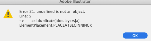

hi Carlos
thanks for this although im having trouble installing it script editor is saying "A identifier can’t go after this identifier."?
Ton Frederiks
November 14, 2019
You don't need to install it with the script editor.
You can simply open the script using the File menu > Scripts > Other Script...
Or install it in the meru:
https://helpx.adobe.com/illustrator/using/automation-scripts.html
