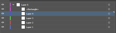

Dear Carlos,
May I know how I can use your scripts in the following layer's structure?
In my case, I want to copy <Rectangle> and paste in (Layer 4,3,2,1).
I think I must modify the script, but I don't know which part I have to modify. Could you please help me? Thanks a million.
Jun 17, 2022 Jun 17, 2022
Hello @pyaes16143374 , do you still need this?
New Here ,
Dear @CarlosCanto, Thank you. No need, my friend helped with that one.
