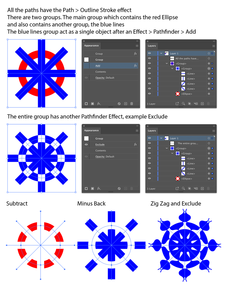

It is an old problem that popped up today.
I saw the answers that Pathfinder only works with outlined strokes.
That's true, but the Pathfinder Effect works different when you first apply an Outline Stroke effect.
I could not resist to create an example with editable strokes.
As long as you don't expand the appearance the strokes remain fully editable.
