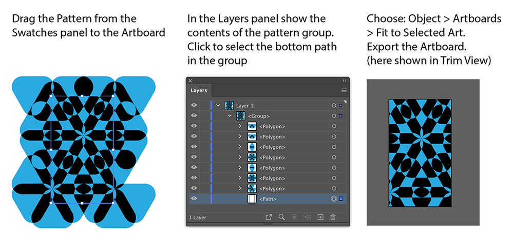

If you double click the pattern swatch in the Swatches panel, you should get the same as when you created it.
If you want a single pattern tile, drag the pattern swatch out of the Swatches panel an use the bottom rectangle to set the size of the artboard.
