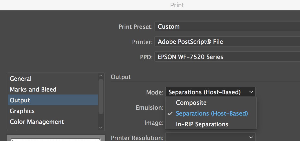

    Hmmm…same problem then. The output mode in the print dialog box will read “composite” and it will be greyed out unless the printer chosen at the top of the dialog box is postscript capable. I’ve attached screen shots to illustrate. In the first image my printer is not postscript capable so the mode is composite and greyed out. In the second image I can access the separations options under mode because I’ve chosen  “Adobe Postscript® File” as  my Printer. Once you get a postscript file you should be able to run that through Acrobat Distiller to create a PDF if you still need to.

    I think I'm almost there. I chose separations host based and I am able to change the frequency and angle of each color but still I can't change the dot shape.

    the color separations in output of illustrator.

    It has been noted why your separation setup is greyed out. It only works with a PostScript printer. Of course, Adobe PDF used to be a PostScript printer when it existed.
