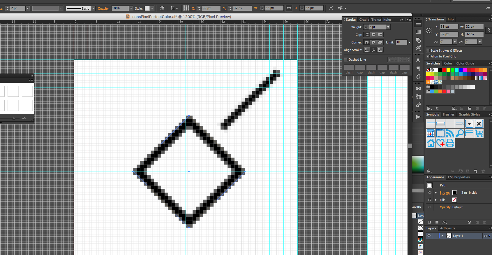

What is more when I make a perfect square transform box shows me two values
First one is Transform Box values which are: 30.012px x 30.012px
Second one is Rectangle Properties which are 28px x 28px - which is exactly what I made.
Why is this first value not an even number? I have noticed that this value is the size of the box with a Stroke aligned to centre. When I change stroke to be aligned to the inside transform box shows value of 28.022 px by 28px
and rectangle shows 28px x 28 px
I think that these two values should be exactly the same but they are not. When I change the transform box first value from 28.022 px to 28px it changes the first value of my rectangle box to 27.978px by 28px

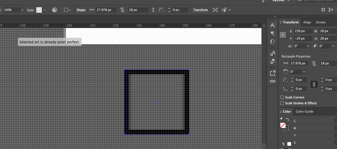

This is something seriously wrong. What is more is that when I change the rectangle properties to a perfect square 28x28px my pixel preview shows this:
Here I decided to use MAKE PIXEL PERFECT and it changed the rectangle value to 27.978px x 28px and then it told me that it is PIXEL PERFECT:
This is definitely not pixel perfect and it should be!!
Similar things happens to lines

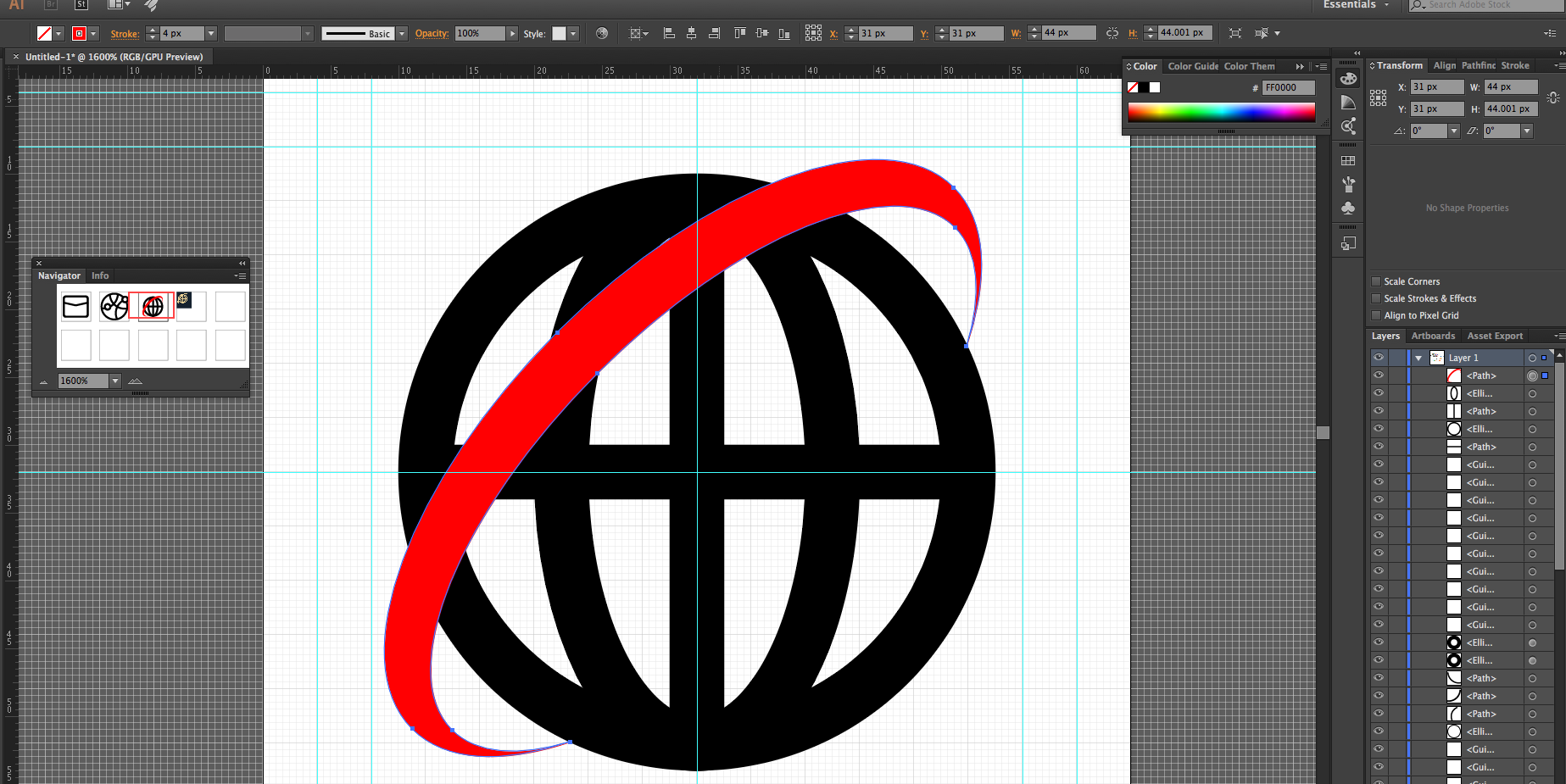

I just installed Illustrator CC 2015 and it also does not allow me to change values of transform box into an even number.
Installed Illustrator CC 2013 and pasted there this icon I made in CC 2015 with a globe. In CC 2015 ( Picture below) transform box displays 44px x 44.001 px - And I am not able to change it.
After pasting the same icon to CC 2013 transform box displayed again a weird number but it did allow me to change it!!
In Illustrator 2013 I am able to input any number into transform box and it works!
Now some of you might tell me to create my icons in even number size in the first place so I do not have to change it. BUT THIS IS EXACTLY WHAT I AM DOING.
Illustrator changes the size of the icon into a weird number right after I will rotate it or use a pathfinder.
