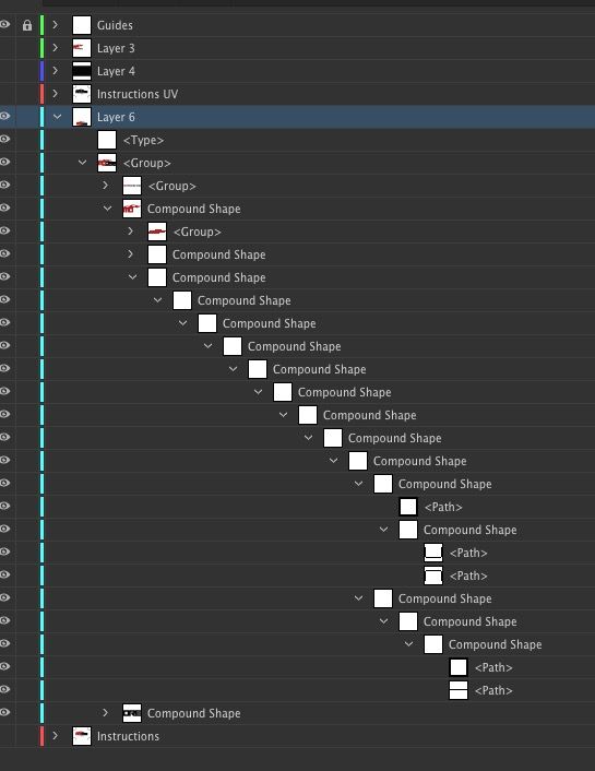

My best guess as to the problem was the deeply nested Compound Shapes. Like.. the file had compound shapes inside of compound shapes inside of compound shapes and all of the compound shapes seemed to have different appearances in terms of their fill and stroke. I don't necessarily know why that would cause an issue, but it does and i'm not shocked based on the other compatibility issues i've seen in 2020.

edit: here's a screenshot of the nested structure of the compound shapes. Like.. they went really deep.

Good news, I've determined that version compatibility is the main issue you're seeing. If i open your PDF file in Illustrator CC 2019, it appears to work just fine. The issue of disappearing letters is exclusive to CC 2020.
Bad news, and I don't mean to insult you or whoever created this file.. but wow, this thing is a mess. I'm not so much surprised that this file doesn't work in v2020... I'm more surprised that it worked well in any of the previous versions of illustrator..
