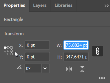

As you discovered, you will need to draw a rectangle. You can do that accurately. With the rectangle tool, click anywhere on the artboard to bring up the rectangle dialog box. Type in the height and width of the artboard. Double click the origin of the ruler in the upper left. That will set the 0/0 origin to the upper left of the artboard.
Open the Transform panel or the Properties panel. With the rectangle selected, click the upper left corner of the origin icon and type zero for X and Y.

Perfect!  That's exactly what I want, thank you.
