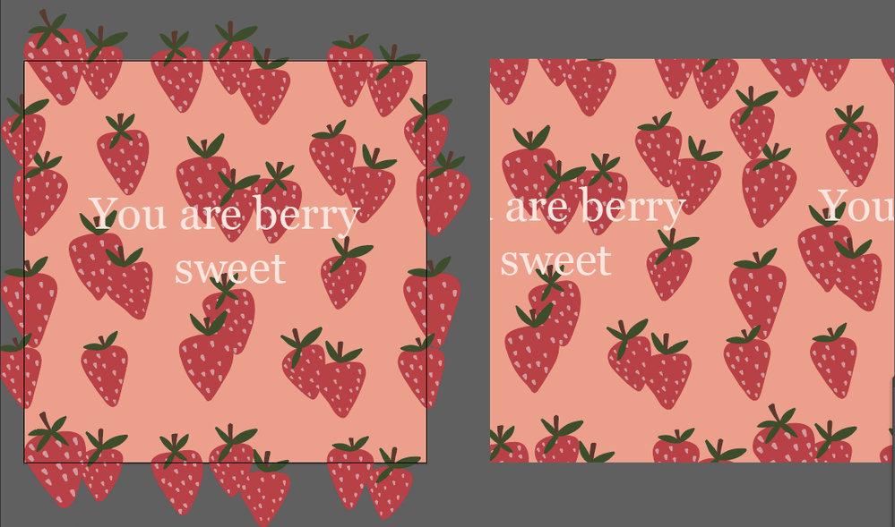

I've been creating successful pattern tiles the "manual" way for some time now (I do not use the Pattern Tool in AI). Recently, when I create a pattern tile and drag it into the swatch panel, it results in a shift and the pattern is not seamless.
Below is my process:
  • Create rectangle/square background (pink in my example)
  • Create pattern design on pattern tile.
  • Transform --> Move the top and left objects onto the right and bottom of the tile.
  • Select the pink background square and copy and paste to the back. Make sure bounding box has no stroke, no fill.
  • Select the entire pattern tile and drag into the swatch panel.
  • Create new rectangle/square and fill with swatch to test.
This has always been a successful way to make patterns for me. I have no idea why it is shifting now. I also reviewed my layers panel and couldn't find any clues there.
In the attached photo, the left side is the pattern tile I created and the right side is the swatch that I end up with.
Any help is greatly appreciated!

I tried creating the pattern using the Pattern Tool in AI, and the below photo is the result. I'm lining up the no stroke, no fill box exactly behind the original background square so I'm not sure why this is happening. I also tried a new document and a new pattern and the result is the same.
Mar 01, 2021 Mar 01, 2021
When applying a pattern to an object, the pattern repeat is not aligned to the object, but to the document's geometry. The pattern will start at 0,0 and then fill the object depending on where the object is located.
I don't really understand why you are doing what you are doing there. Can you give us that background? Are you trying to send that pattern for printing?

If you use the pattern tool, don't use the no stroke no fill object.
You can star with your square and add berries and text.
