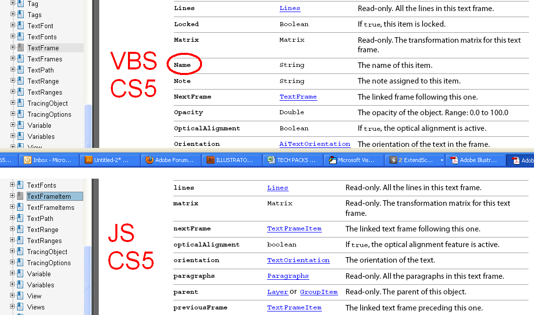

Oh, man....  this was driving me nuts.  This script wasn't working for me. It was hanging on the line "var iframe = ilayer.textFrames["Name"];".  Turns out I had to rename the text object before the script could see the name (even though it showed up as named in the AI object Options dialog).  This appears to be true for any object.  They all appear to get default names, but they aren't names a script will see.  You have to rename the object for a script to see the name.  Maybe someone can verify that for me, or perhaps that I'm just loopy.
Also, in the CS5 Scripting Reference it doesn't even show that textFrameItems have a name property.  That was the first thing that through me off.  When the script didn't work I thought, of course it doesn't work, textFrameItems don't have a name property.  Turns out they do

Ahhh, yes....  still getting the hang of object oriented programming   But still, in the Scripting Reference everything else (including legacyTextItems) shows a name property, but not for textFrameItems.  That's what threw me off.  Thanks for setting me straight.

Red, sorry about that, I didn't think of it. I wasn't aware it is not in the Documentation, I come from VB and usually work on a VB version first then rewrite to JS, I just love the VB IDE (don't like at all the ESTK). It turns out THERE IS a name property in the VBS documentation, I'm not sure what's going on, there's a bunch on differences between the two.
About the naming thing, what you see in the layers palette is not a name, but more like a "preview" of the text, if not explicitly named, the name property returns "null" (I guess, or an empty string, but not a name).
