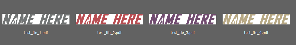

The script has to be placed in the folder so that it appears in File > Scripts first, and then it should work. Problem is when Illustrator restarts, the action won't have it any more. To fix when restarted, you have to show the File > Scripts menu by clicking it & mouse-over the Scripts menu item, and then re-load the action.
In my screenshots, I show this working on CC2015 Windows7
This is not relevant to this question, but I just wanted to share my test results.
I used a simple script to assign a "random" Cmyk color to the document selection.
#target illustrator
function test(){
    var doc = app.activeDocument;
    var randomColor = new CMYKColor();
    randomColor.cyan = Math.random() * 100;
    randomColor.magenta = Math.random() * 100;
    randomColor.yellow = Math.random() * 100;
    randomColor.black = Math.random() * 50;
    doc.pageItems[0].selected = true;
    doc.defaultFillColor = randomColor;
test();
I then processed a set of 4 files 3 different times to produce 3 unique configuration sets using the Actions Batch feature.
