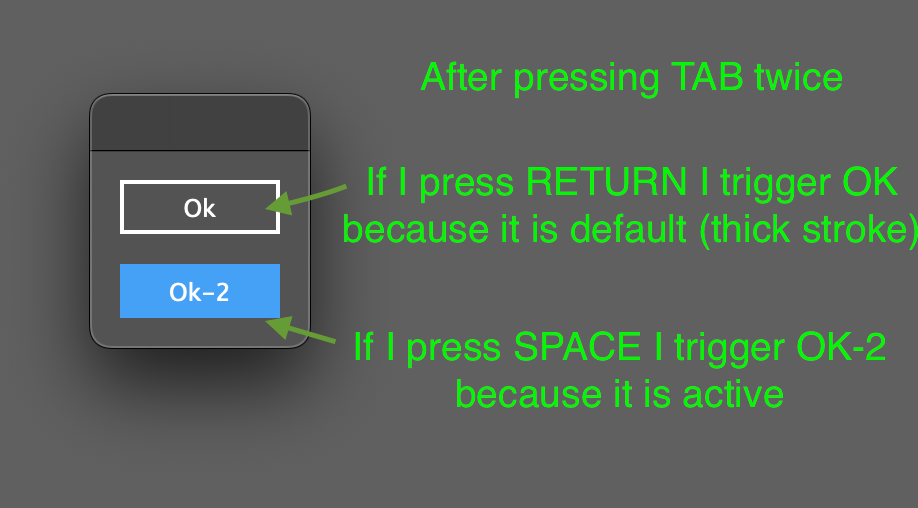

Nov 12, 2025 Nov 12, 2025
Hi @Silly-V when I perform OPs test on your script:
> Run Script
> press Tab twice to hightlight "OK-2"
> press Enter
>> get message "OK" but it should be "OK-2"
I get the same result as OP, which is expected behaviour (for me!). I don't agree that "it should be OK-2".
But I think OP has now reconciled with the way it works. Good luck with your scripting @0771 !

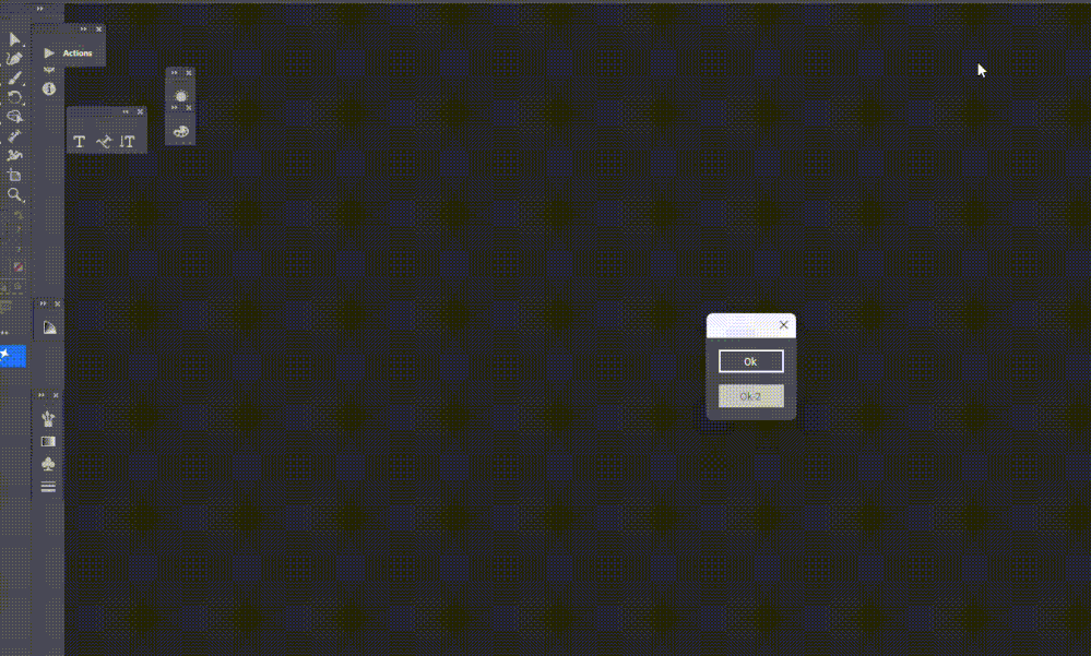

Valorous Hero ,
I don't know at this point, maybe it is a bug with my one computer -- because when I tab twice, whether I do Enter or Space, it always says "Action from Button 'Ok-2'" when I get the Ok-2 highlighted.Recording 2025-11-12 063551.gif
