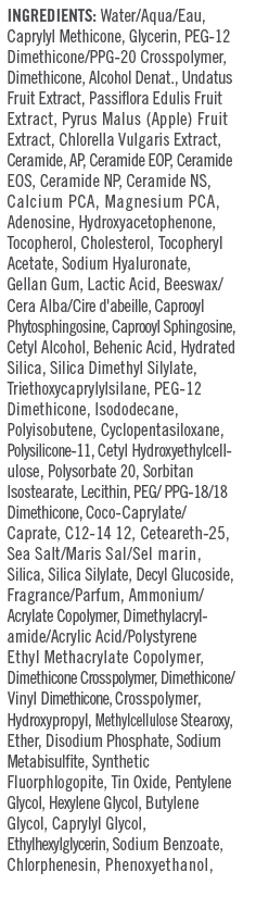

Would anyone give me some guidance regarding ragging this long column. Its an ingredient list on the side of packaging. I'd like to keep it this width. I've done alot of manual tracking and soft returns to get the rag like this (which I think is ok). However, I've become aware of justification settings, which seems like it might be an easier solution and provide a better looking result. Where do I begin that? First, nothing happens when I have preview on and I play with the percentages.
Would appreciate suggestions on what percentages to use in the different fields and any other thoughts people might have.
Thanks!

So this is the text that you have adjusted manually? You would first have to delete all the returns from it before justification will do anything.

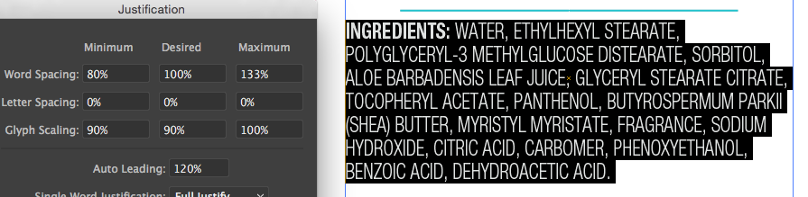

Justification has a bug  if you change to many numbers, so go slow and keep preview on. You may just be changing the minimum without changing desired is why it may appear nothing is happening.
Default settings
Glyph Scaling  90% - as I assume you are looking for a less ragged edge
Glyph Scaling  80% - type is getting hard to read, but you have one less lien of type.
