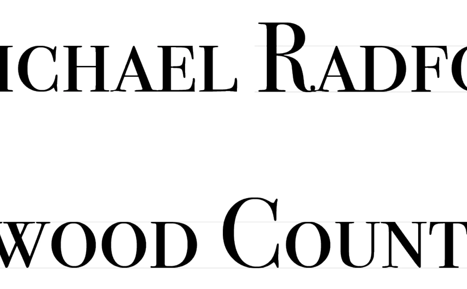

I am rasterizing text and selecting type optimized. When I do this, the resulting image has a faint grey line but it is not throughout the entire text (Michael doesn't have it and Radford does, see below). And it seems to only be happening with the font Bodoni 72 Smallcaps Book.
I have found a work around for the time being. First expand then rasterize. It doesn't seem to be happening with the few other fonts I've tested or when I select art optimized.
Any ideas how to fix? Thanks so much.

At what size are you using the font?
Large point sizes do not need Type Optimized.
July 26, 2023
Can't recall off the top of my head...35pt, possibly. I am laser engraving the art on different materials and the type optimized gives a much cleaner engrave.
Ton Frederiks
July 26, 2023
Expand will give you something similar to Art Optimized, because the type does not use hinting anymore.
