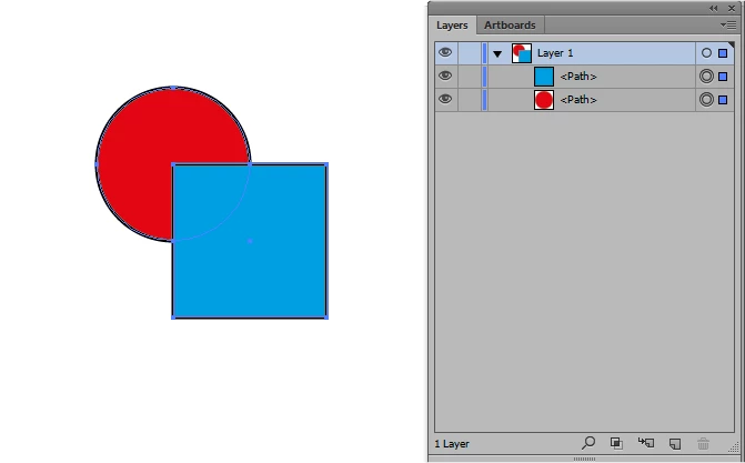

m1b
May 28, 2022
HI @femkeblanco, I don't trust myself to remember for how long the behaviour has been like this but, when I test now, rasterize by default chooses the bounding box of the clipping mask page item. Like this:
Using getItemBounds function makes a better attempt:
But still only uses rectangular bounding boxes and not actual shape intersections, for example it fails like this:
I had a look at the thread you linked to, and it might be as the correct answer states that the bounds used are the clipped contents, however I wonder if the OP's file was set up badly—they don't show the wireframe or layers.
- Mark

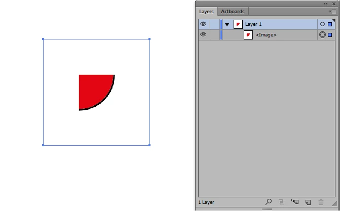

m1b
May 28, 2022
Hi @Rob.thedc, try this script. I've added a function I made called getItemBounds which attempts to get the items bounds even if it's clipped. It uses a bunch of other little functions to work out intersecting bounds etc. Probably can be made much better but see how it goes for you. I tested in your code and it seemed to do the trick.
- Mark
