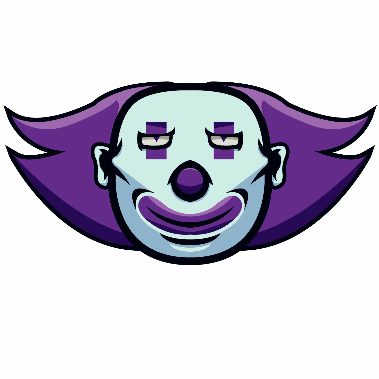

I'm making a mascot design in Illustrator CS6 and I've made 1 half of then mascot and I was intending to reflect it with the reflect tool but when I do reflect it, it has a small gap in between the 2 reflected halves which makes a line going all the way down my work. I've made sure the middle of the mascot is completely straight but it still has the same problem. Does anyone know a fix?

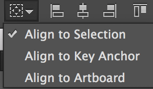

Align to pixel grid also take out white line. You can find it on the right of control panel
Seamlessly align your artwork with the pixel grid...

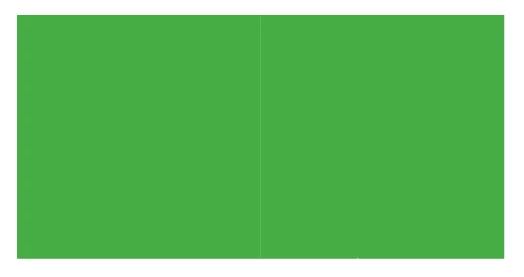

It's pretty normal that this also happens with simple shapes. It depends on their exact position in the pixel grid and it depends on zoom factor.
To check if it's caused by actual misalignment of objects, you will need to open Preferences > General and turn off antialiasing.
Two simple rectangles, perfectly aligned:

lil Brit
lil BritAuthor
August 19, 2018
I've made sure they are and I've done the reflect part but still the same result.
