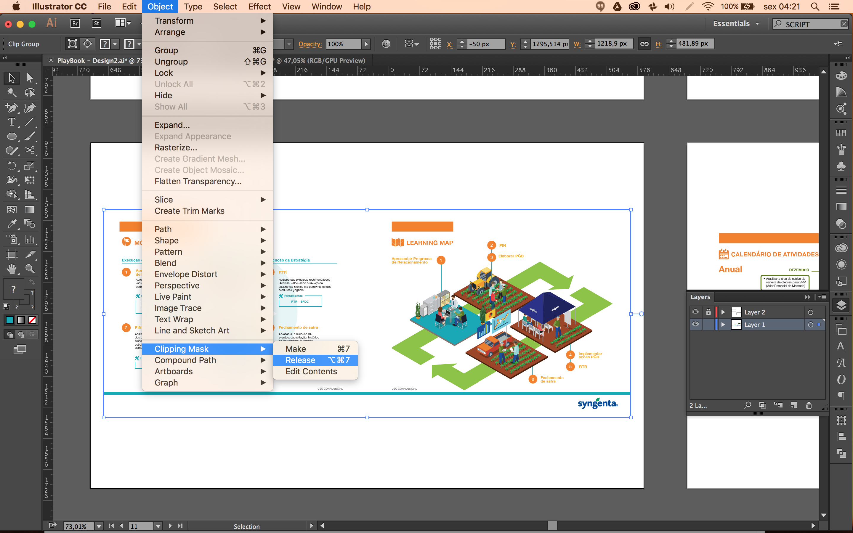

Apr 01, 2016 Apr 01, 2016
As simple as this..
