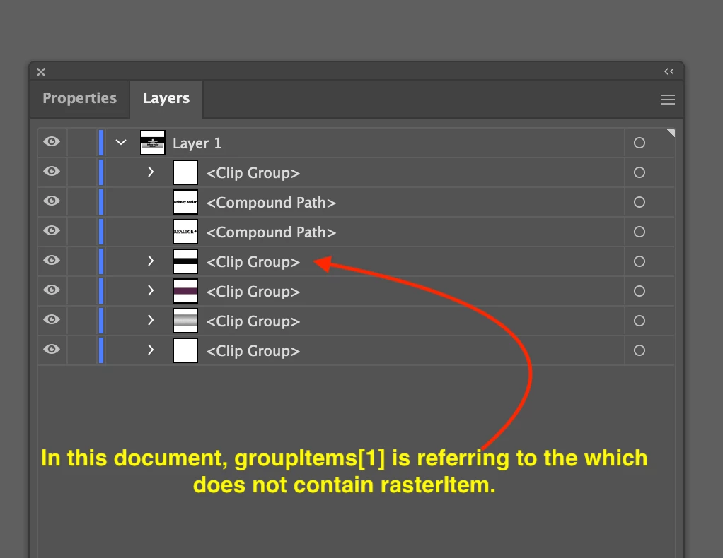

The script is failing on the document where faux silver item exists and its is because the number of groupsItems differ in both documents. See screenshot for clarification.
1. Traverse all groups and delete rasterItem, but this will fail when another group may contain raster element as well.
2. Secondly, if you know, it is always be the second last group(from bottom) in the layer, then use below version
