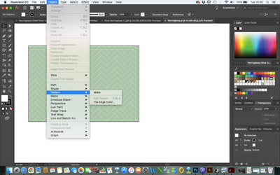

Hi Tom,
I don't know whether i'm doing this right but after a quick look on youtube to change the document unit I went to file > document set up and changed the document unit to pixels...
Couldn't figure out how to check if my pattern contained fractional pixels..... I doubled clicked the pattern as you suggested in the swatches panel but nothing came up?
Next  I went to effect >  document raster effect setting and changed resolution to 288 as you suggested...

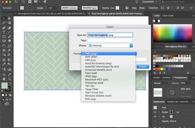

But now when I go to export > export as an option for PDF doesn't appear and my printers need to have their documents as a PDF.

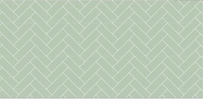

Anyway so I just created the file again my art board has to measure 125 x 60 cm then I changed it to pixels added the pattern to my art board again then went to effect > document raster effect setting and changed resolution to 288 then went to the usual export > export as and the option for PDF came up this time I saved it. But then when I clicked on the image the annoying lines still appear as you can see below....
Also now i've exported it once as a PDF if I try to export it again as another PDF the PDF option doesn't even show up anymore like on my first attempt?

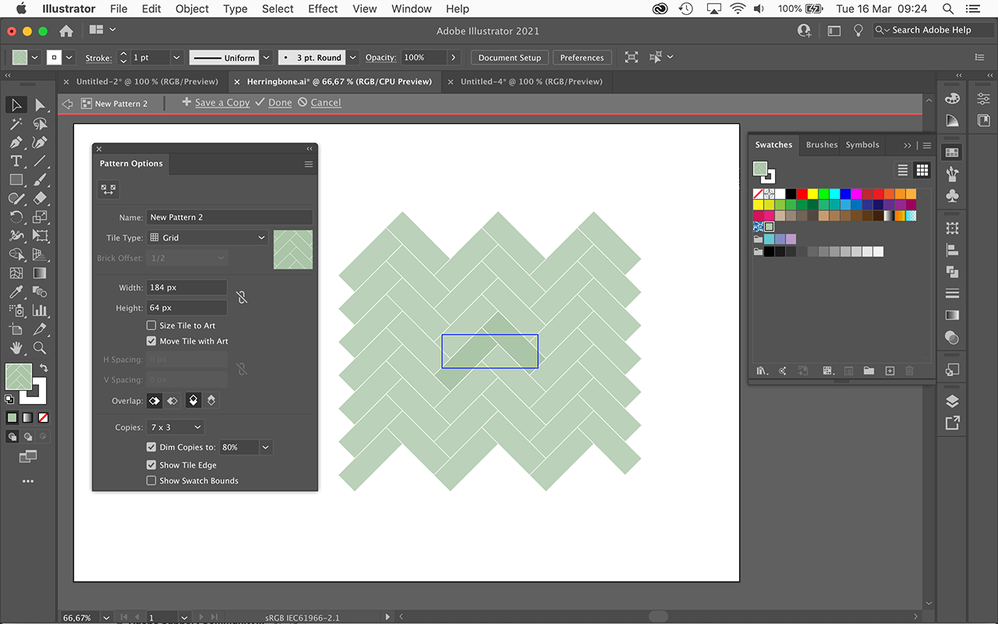

Mar 16, 2021 Mar 16, 2021
Hi Rebecca,
units can be changed in the document setup or by right or ctrl clicking the rulers.
If you double click the pattern in the Swatches panel, the Pattern Options panel should come up. As an alternative you could select your pattern swaych in the Swatches panel and choose Object > Pattern > Edit Pattern.
When exporting the pattern you can set the PPI in the Export options, no need to change the Document Raster Effects setting, this is used only when you apply effects/filters that generate pixels.
When the printers want PDF, which is good news because you can keep it vector, you do not need to export, you can do a save as Adobe PDF. If they use a high resolution device to print you probably won’t see the lines in the output.

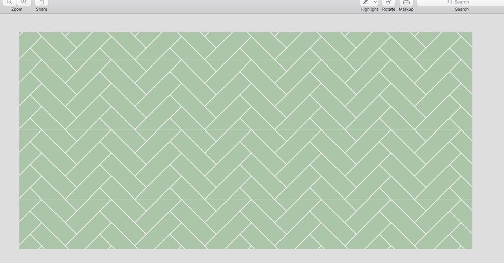

I've saved the pattern as a PDF but the lines still show really don't know where I am going wrong here?
Here is my example, check the size of the pattern in te pattern maker.
