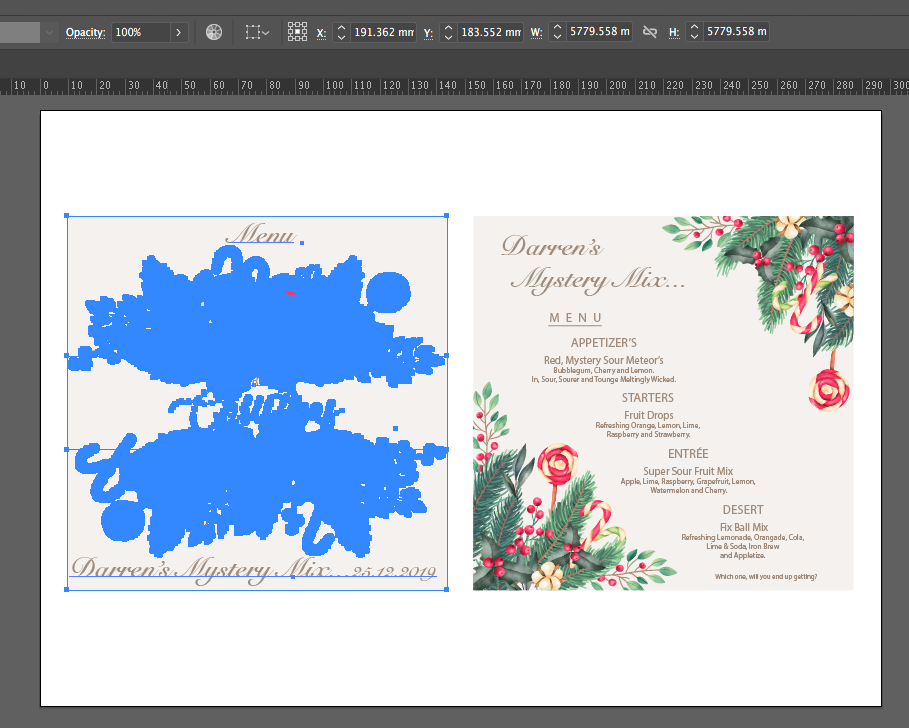

I have some artwork fitted in my A4 canvas, yet each piece of artwork with bounding box shown states the dimensions are bigger than they are? What's going on here and how do I fix this?Screen Shot 2019-12-07 at 15.38.17.pngScreen Shot 2019-12-07 at 15.38.58.png

Judging by the left part of the upper image you have some invisible paths, maybe behind the rectangle, which actually seems to fit the Bounding Box.
I believe the worse issue is with the right side where the Bounding Box is indeed larger, and I believe that you have some invisible paths or stray points or something.
What happens if you Ctrl/Cmd+A to show everything, maybe in Outline View (Ctrl/Cmd+Y)?

 Thank you for you reply. Yes there are somethings that are hidden in a mask ‘I think’, but what I don't get is the canvas is A4 which is 210mm x 297mm, and if you look at the Width and Height of the right image, it's 151.193mm x 5779.558mm and the left image is 5779.558mm x 5779.558mm. How can they fit on A4 when they are greater than A4. I really don't understand this?

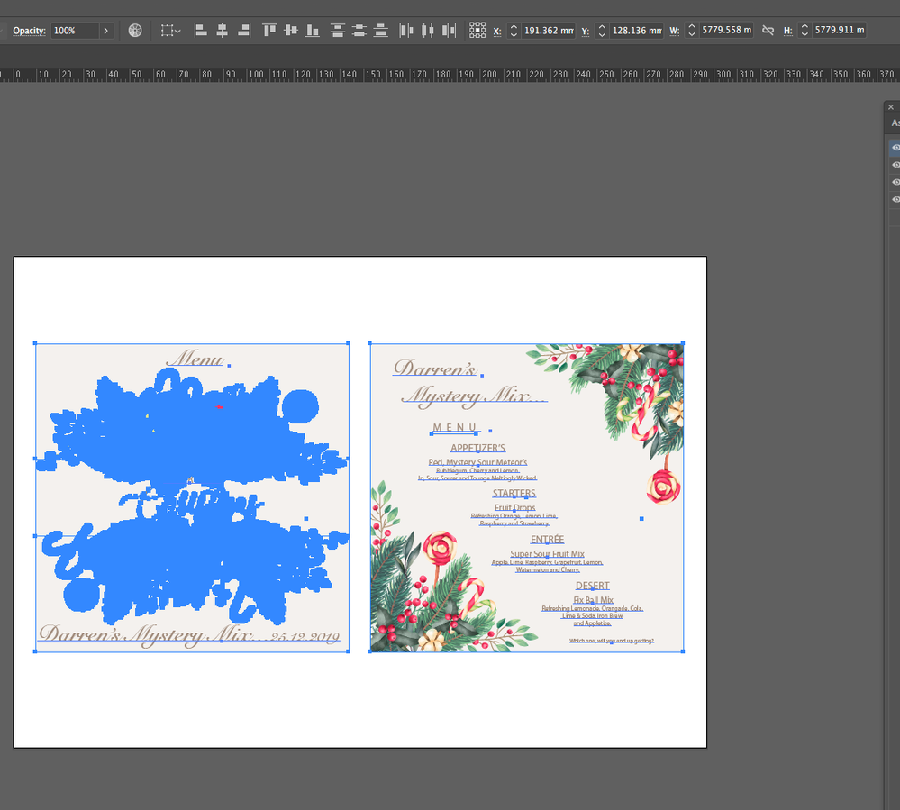

 For reference, a screenshot of ‘select all’, and one of ‘outline view’.

Screen Shot 2019-12-07 at 18.46.42.pngScreen Shot 2019-12-07 at 18.47.03.png

Now that you have mentioned the actual numbers i can see that they, 5779.558mm x 5779.558mm, equal the size of the entire Workspace of 16,383 x 16,383 pt.
I believe that there is either something extending to (which could be related to Guides) or otherwise being at/beyond the boundaries of the Workspace, or there is something wrong with the preferences.
